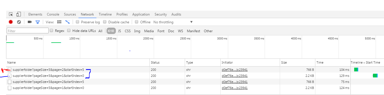

I'll come back at you. I used AlfFilteredList to contain my AlfListView and I define some widget like (TextBox, FilteringSelect, DateRange) in property widgetsForFilters (ALfFilteredList) and evrything work perfectly about filter but when i add widget Paginator after AlfFilteredList that's give some problem during the click on button forwad paginator the request reload my page twice.
First when my page load this code run:
    config:
      loadDataPublishTopic: "ALF_CRUD_GET_ALL",
      loadDataPublishPayload: {
     url: "ceri/supplierfolder",
      itemsProperty: "alldocument",
       config: {
          documentsPerPage: 5,
          pageSizes: [3, 5,10],
I do not understand why my page is twice reloaded. The red is call when i click on button forward paginator and answer realod page and call the blue request.
I need your help.
Thanks for advance

One of the main issues I encountered when developing Aikau is the inconsistency in the schema of the REST APIs that Alfresco had originally developed (this is subsequently being addressed with the new versionable APIs that are being developed). One of the issues is how pagination data is handled - for example, sometimes the API is expecting "pageSize" and "page" parameters, sometimes it is expecting "skipCount" and "maxItems", sometimes it's expecting "startIndex", etc.
This is one of the reasons why Aikau has separate services for requesting data - because they can normalize the data into a consistent schema that the widgets expect.
It would definitely be worth checking that the API you're using supports the pagination parameters that you're passing... it might be that you're not able to use the CrudService and that you need to have a custom service.
Are you calling a custom API that you've written or is it an Alfresco API? Does it definitely handle pagination? What parameters is it expecting?
Why you're getting an error I can't be sure - I'd usually recommend breaking on exceptions in the debugger and/or stepping through the loadData functon and subsequent function calls to understand what is happening.
I dont' know why i encountered this problem. I have a custom api that i call via  loadDataPublishTopic: "ALF_CRUD_GET_ALL" and the response of my api return Json data contain ("totalRecords": 6,  "startIndex": 0, alldocument: [...]).
I don't know how i can resolve this today.
Need more help please.
Thanks

I don't have enough information to help you further unfortunately as I don't have access to your environment or code... I've given you some suggestions for how you can try to debug the problem. Have you followed any of those? Have you tried breaking on exceptions or stepping through the code?
