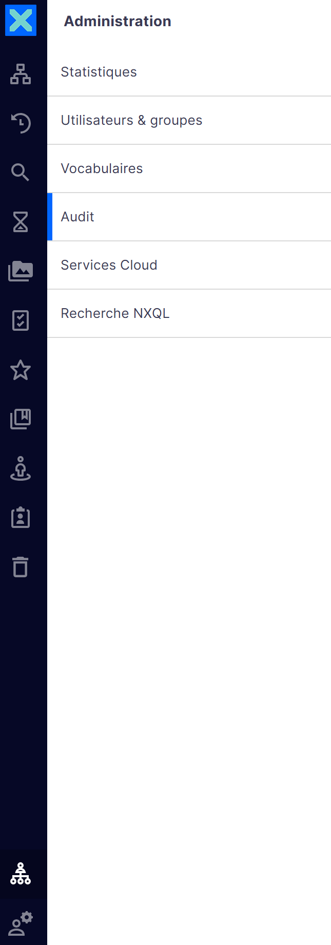

I'm a Nuxeo beginner using version 2025 installed from the ZIP archive. I installed the nuxeo-multi-tenant addon.
I'm trying to follow the documentation to enable it ("Admin > Tenant isolation > Enable button"), but the "Tenant isolation" tab or the "Enable" button is not present in my admin section.

This add-on relies on the JSF UI that has been deprecated since LTS 2019 and will be removed. You should not use this add-on for any new work in Nuxeo.
