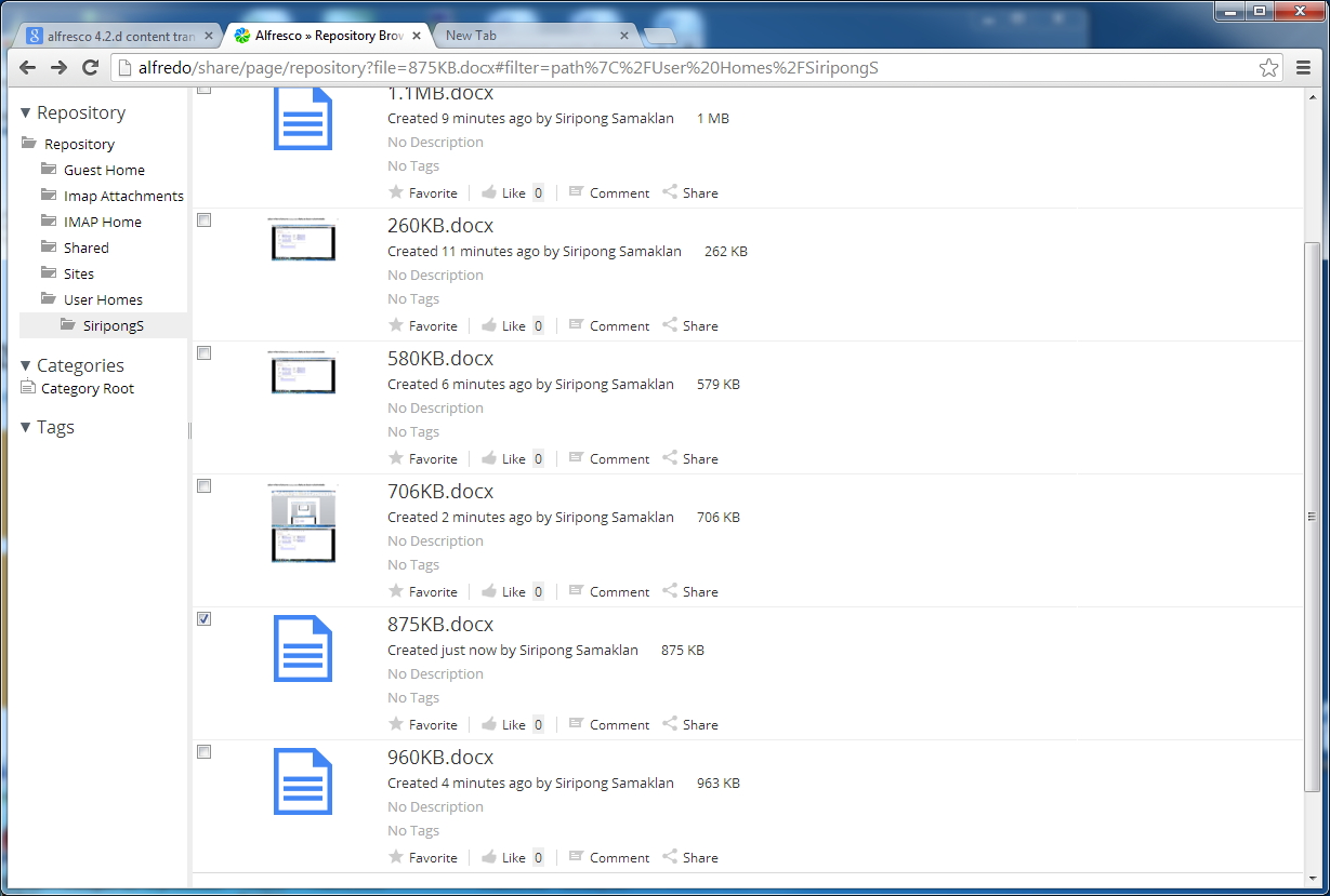

I can't preview .docx files that larger than 250KB on Alfresco 4.2.d,
And alfresco not generate thumbnails for document(.docx) that size larger than 800KB (see attachment).
I think it's because content.transformer configuration.

Try following setting if you enable OOoDirect
content.transformer.complex.OpenOffice.Pdf2swf.extensions.doc.swf.maxSourceSizeKBytes=5120
content.transformer.complex.OpenOffice.Pdf2swf.extensions.docx.swf.maxSourceSizeKBytes=5120
Try following setting if you enable OOoJodConverter
content.transformer.complex.JodConverter.Pdf2swf.extensions.doc.swf.maxSourceSizeKBytes=5120

Thank you Douglascrp & Kaynezhang,
Your Guide solved my problem.
Note : Kaynezhang's Config override configuration from "(Alfresco_Root)/tomcat/webapps/alfresco/WEB-INF/classes/alfresco/subsystems/Transformers/default/transformers.properties"
