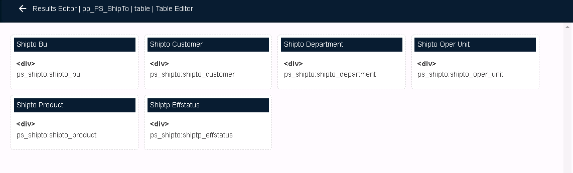

Page Provider table layout

The name "ps_shipto_shipto_customer" is the same you can see in the Table layout changin the ":" to a low bar.
