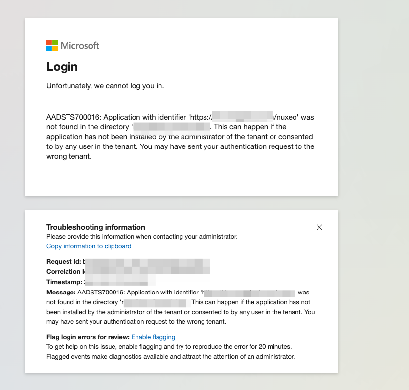

I'm trying to set up authorization via the saml azure provider.
I created a provider in Azure and specified the redirect point URI https://mydomain.com /nuxeo/ui
I created a configuration file according to the recommendations from the knowledge base, with a description of the module, metadata and attribute mapping.
When trying to authorize, I get the following error:
AADSTS700016: Application with identifier 'https://mydomain.com/nuxeo' was not found in the directory 'msg Plaut Central Asia'. This can happen if the application was not installed by the tenant administrator or no user in the tenant has consented to its installation. Perhaps you sent the authentication request to the wrong tenant.
I understand that my error comes from the nuxeo.conf configuration, but I can't figure out what I configured incorrectly.
Part of nuxeo.conf settings:

I would appreciate any help!
03-28-2025 04:56 AM
The problem was in the saml application in azure, misconfigured by our administrator.
