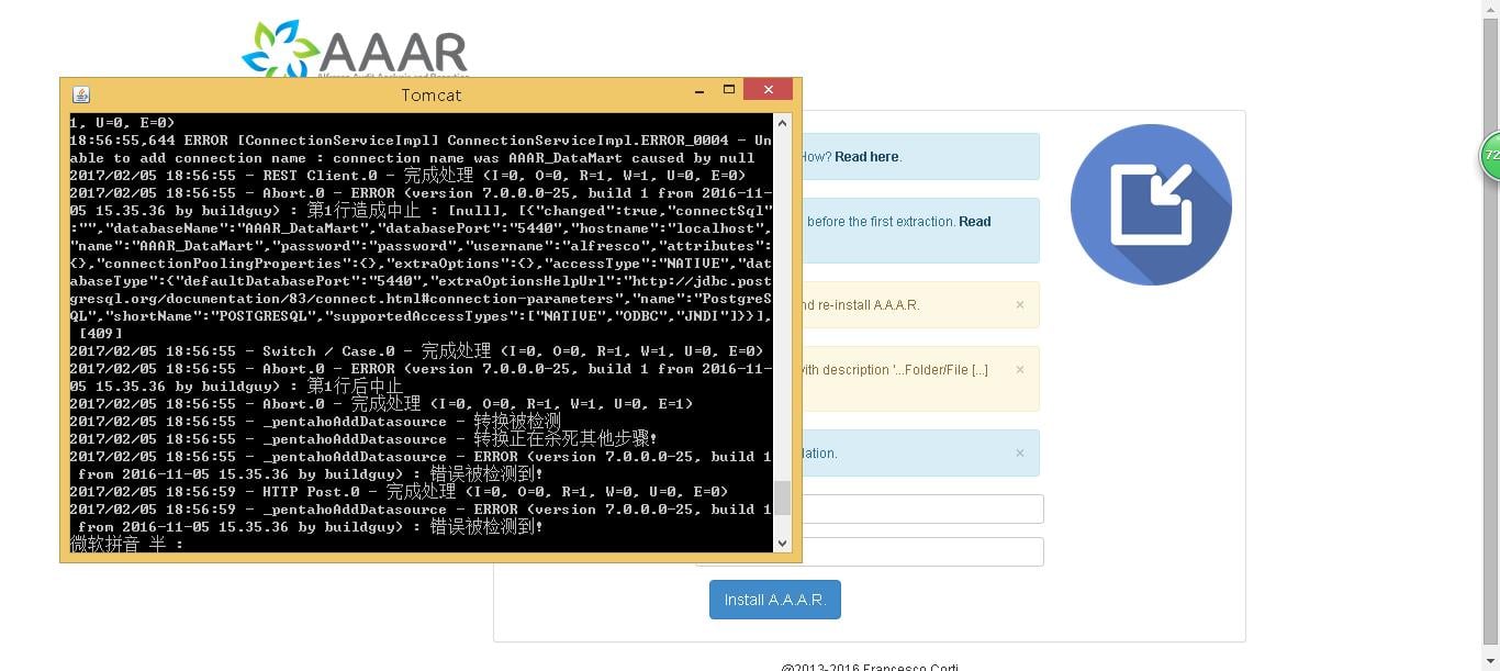

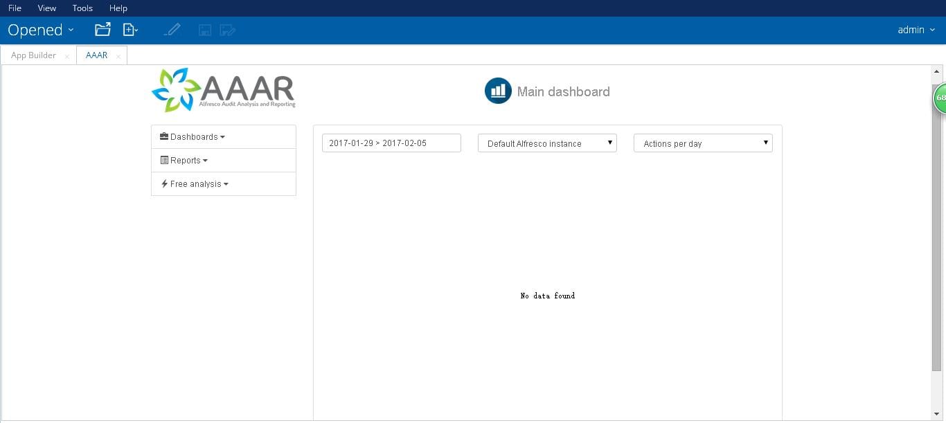

I'm following your steps to install A.A.A.R,every step goes successfully.But when I use it,it tells me "no data found"(I've already upload some datas on alfresco),and I have runned "AAAR_Extract",But nothing has changed,and "AAAR_Extract.bat"was drop out immediately!
I check "pentaho-solutions\system\AAAR\endpoints\kettle\logs\AAAR",but it shows "dummy"! So I guess maybe I made a mistake during the installation,when I try to press the button "install A.A.A.R." to re-install A.A.A.R. it shows me "ConnectionServiceImpl.ERROR_0004 - Unable to add connection name : connection name was AAAR_DataMart cause by null"

I've already upload some datas on alfresco,my dashboard is empty.when I tried to run "AAAR_Extract" ,and"AAAR_Extract"was drop out immediately.
This picture is when I tried to re-install,but something wrong.

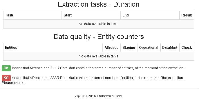

This image is when I open the " AAAR_extract.bat". I noticed the text inside "/user:admin /pass:admin /param....." My Alfresco login password is "password" not "admin",is it related to "AAAR_extract.bat" drop out immediately?
