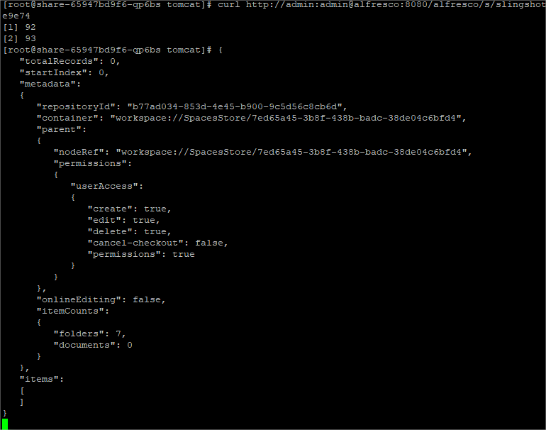

Well, now I can login to alfresco... to share... but cannot make a request on the Documents, sections (My files) because it just get stuck on the response.
I actually did a "curl http://alfresco:8080/alfresco/s/slingshot/doclib/doclist/documents/node/alfresco/company/home?max=50..." from the pod.
As you can see, it returns an "Unauthorized" message, but never actualy returns the control, and also happen if I do it with usr
ss.
The same containers works perfectly in my local machine with docker.
Here's the share.log output (i'll put the complete as an attachment):
2019-07-16 21:38:11,078 INFO [org.springframework.extensions.webscripts.connector.RemoteClient] [http-nio-8080-exec-4] Exception calling (GET) http://alfresco:8080/alfresco/s/slingshot/doclib/doclist/documents/node/alfresco/company/home?max=50&filter=recentlyModifiedByMe&alf_ticket=TICKET_58e4d9da0b50d24cda3dc9471be46a9d4b3e9e74
2019-07-16 21:38:11,079 INFO [org.springframework.extensions.webscripts.connector.RemoteClient] [http-nio-8080-exec-4] Error status 408 Read timed out
java.net.SocketTimeoutException: Read timed out
I extended the amount of time (x3) to wait before ends in timeout and still didn't work.

It looks like you have low resources for Alfresco. How much RAM is assigned to Tomcat?
