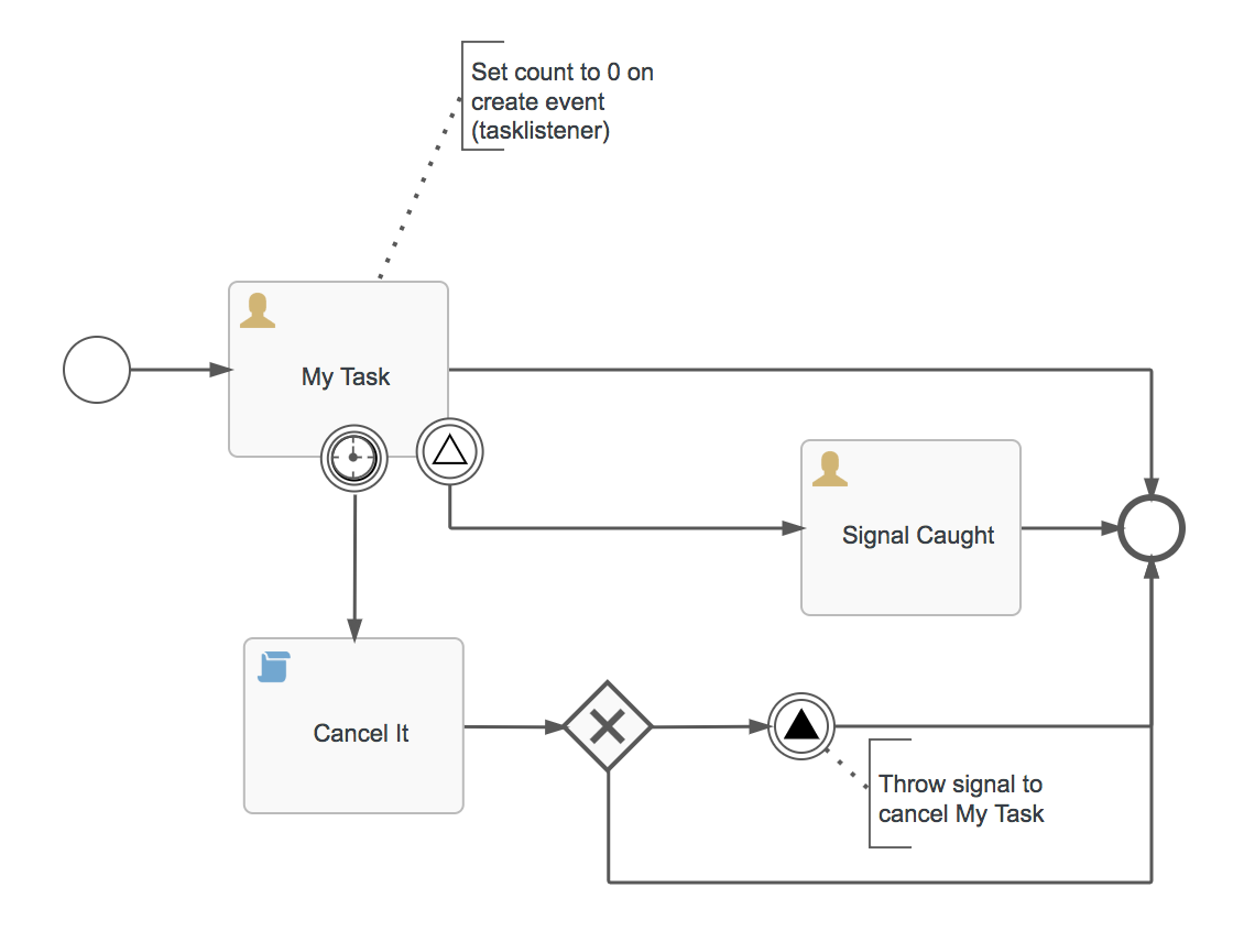

After the Boundary Event Timer fires the 20th time you want to cancel the attached task.
If this is what you need, then you could add a counter to the boundary event either as a script task or execution listener. After you hit the last timer, throw a signal to cancel the original task.
See simple example below:
Obviously you can streamline this by throwing the signal inside the timer event boundary listener and checking the count there, but the basic approach is the same.

Ok thanks for the details.
So if I understand correctly.

Signal throw and catch worked! Thanks for your help!

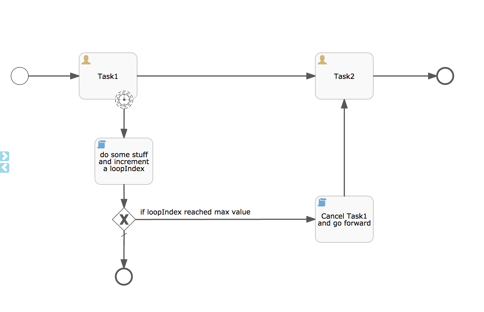

what about such a construction, is it solving your needs?
How can we cancel a user task in Script Task?
