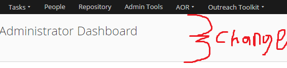

See in the picture below?  I am not trying to change the black section, I have already done that and it works great, I am trying to change that 2nd, title section.  Both of your post are great ways of changing the black, but not the part I indicated below.  I hope that helps you understand what I am trying to do.  I just want to change the background color to start.

Thanks for providing the additional information - that's very helpful.
The LESS variable you want to change is called @shareTitleBG - unfortunately for some reason it was not in the defaults.less file in Aikau where it should have been. This means that you can't currently make use of it (because it gets set after the theme overrides have been applied), however I've resolved the issue (see this PR: Move LESS variable to correct location by draperd · Pull Request #1318 · Alfresco/Aikau · GitHub ) and it will be available for use with the Aikau 1.0.99 release which will be out later this week (at the time of writing).

Aikau 1.0.99 has now been released so is available for you to test
