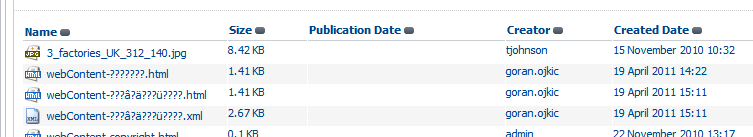

And this is what i get when i try to upload files.
[img]http://i245.photobucket.com/albums/gg59/ojke/greece.png[/img]

Is the database connector configured for UTF-8?
db.url=jdbc\:mysql\:///${db.name}?useUnicode\=yes&characterEncoding\=UTF-8
Thanks,
Mike
glava
Champ in-the-making
Champ in-the-making
Thanks mate, you saved me Smiley Very Happy
It works now.
