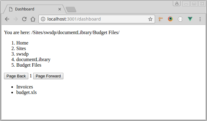

At the same time I've added the breadcrumb. You can view the state of my project at the time of writing by checking out this tag.
I plan to learn as much as I can about accessibility as I implement this client so did some research on accessible breadcrumbs and found this useful post (which despite being quite old still seems relevant). This means that whilst my breadcrumb trail is functional (and accessible) it looks very strange! I'm more interested in accessibility and function than style at the moment but will return to the visual look later.
