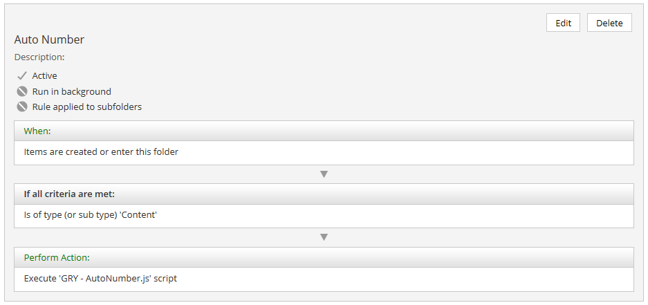

Below is the simple test script and rule I created.
GRY - AutoNumber.js
var dbid = document.properties['sys:node-dbid'];
document.properties['gry:fileNumber'] = 'DOC_' + dbid;
document.save();Simple rule on folder to run the above script:

The non-consecutive numbers aren't a problem for us and document copies do get a new ID with the simple rule created in the original post but I do see how this is not really ideal. It didn't really sit right with me and I'll look into using the AttributeService as that seems to be a better option. This must be a very common request, are there any good examples out there of people doing this or something similar?
