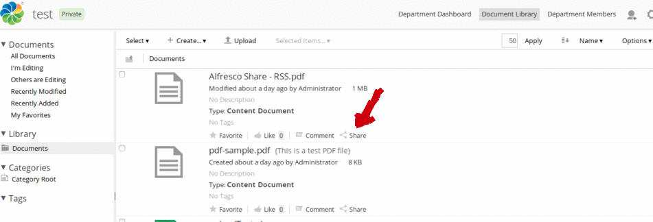

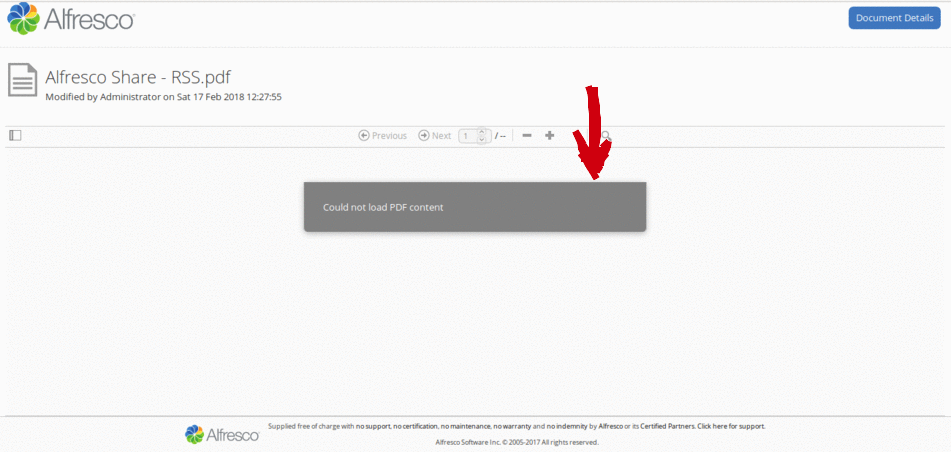

Hello,
I am not able to preview the documents while trying to share and view them.
Either it's a word document, pdf document or xlsx document. getting the same error message on the screen while viewing.
I don't know why this happening and where should I check. Even I am not getting any exception at console. I have tried but not able to get anything.
If anybody have any idea, please guide me.

02-19-2018 02:56 AM
Please check the browser console / network tool for any errors loading the PDF document or previewer component. Also check the server-side logs (alfresco.log/share.log/catalina.out) for any issues accessing the content. For PDF there should not be any transformations going on for preview but maybe an addon you have installed (if any) messes with that).
02-19-2018 02:14 PM
Also, what happens when you open the document details for that document? Does the previewer load? It probably has nothing to do with the quick share feature (the preview should fail on document details too) but it would be good to rule that out.

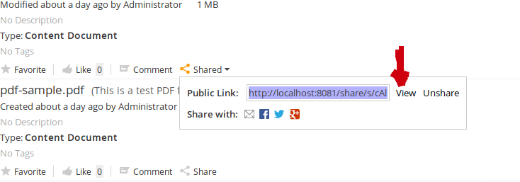

02-20-2018 12:28 AM
No, there is no issue with document details page. Its previewing fine. but after sharing (quickshare- shared), documents are not previewing on document details page too.
