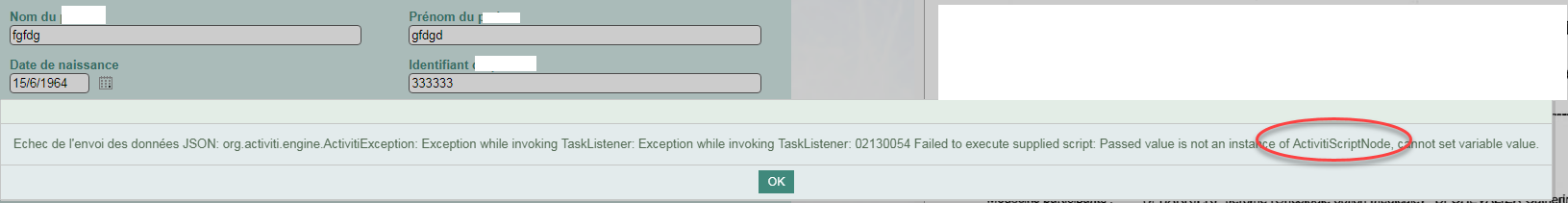

But i get the error " org.activiti.engine.ActivitiException: Exception while invoking TaskListener: Exception while invoking TaskListener: 02130054 Failed to execute supplied script: Passed value is not an instance of ActivitiScriptNode, cannot set variable value."

There is no out of the box API to get instances of ActivitiScriptNode in default Alfresco. In one project for a customer I built myself a custom extension of the Script API to deal with this.
Unfortunately, the scripts run inside the workflow are run as "insecure scripts", so they do not have access to the full scope of the Java interoperability features. With these features it would be possible to manually create an instance of ActivitiScriptNode even without any special API.

03-16-2018 04:47 AM
Yes, that is the annoying part of the workflow-related Script API. Any nodes set via the WorkflowService Java API (e.g. via Share forms) are already ActivitiScriptNode instances because the Java API parts already convert it as such. But when you are running a JavaScript listener, you are already "below" that API layer, and you need to convert any NodeRef you get (i.e. by creating a person) to an instance of that Java class yourself. You cannot do that with just JavaScript. The only way to solve this is to write yourself a small little Java-based extension of the Script API that does that conversion for you.
