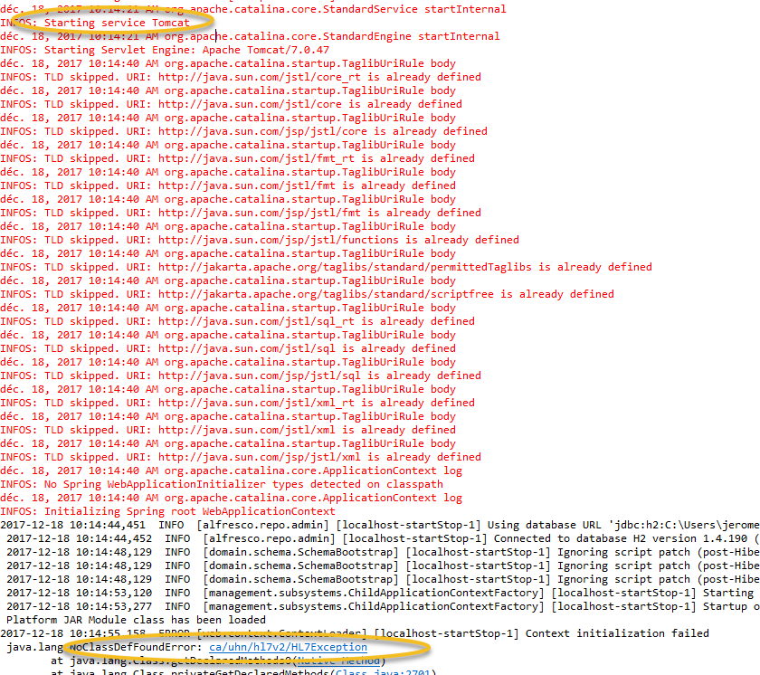

I have reported source code from sdk 2.2 alfresco project to a new alfresco project with sdk 3.0.1. by using the sdk 3.0.1 template.
Some dependencies are declared in platform-jar module POM.xml.

But the jar (hapi-base, hapi-structures-v251, tika-core, etc...) are not created during the build.
And so when i launch the project i have an issue on TOMCAT :
On the former project (sdk 2.2) , the jar were well generated...
How can i solve it ?

All is ok, I solve it by adding dependencies in platform pom file AND in main pom file :
java - Alfresco Context initialization failed : NoClassDefFoundError - Stack Overflow
Thank you
Thank you
