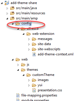

i have succed to add a new theme with alfresco sdk 2.
i need to upgrade to sdk 3.0.1
I understand (but i may be wrong) that src/main/amp/web directory of my sdk 2 project, moves to src/main/assembly/web directory of my project-share-jar :
But what about src/main/amp/config ?

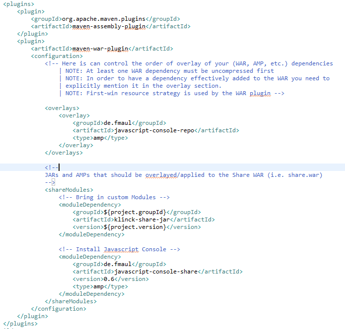

I have updated share-jar pom file like this :
and platform-jar like this :
but i'm not sure it's right.
Thx in advance for your help !

The src/main/amp/config is the equivalent to src/main/resources

Using SDK 3.0, you don't have to configure the overlays.
All you have to do is to include a moduleDependency, as you already did.
Try this... add the parameter <type>amp</type> inside of your moduleDependency.

It doesn't work BUT after reading this doc (Working with AMPs | Alfresco Documentation ) and my main POM.xml, i think i was wrong.
So this is what i have done :
- In my platform-jar and share-jar POM files : i have deleted all my modifications in <build> section (as if i start a new AIO sdk3 project).
- In my main POM file i have uncommented the plugin section about "maven-assembly-plugin".
- In my main POM file in <shareModules> section i have added <type>amp</type> as you ask me, and i have added another <moduleDependency> for Javascript Console like mentioned in the doc.
It doesn't still work BUT it's in progress 🙂

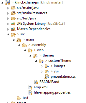

The config folder is in src/main/resources folder.
After reading README.md file located in src/main/assembly/web folder, i move config folder in /src/main/resources/META-INF/resources/klinck-share-jar/ l.
But without success.

Shame on me ! i have added files instead of update present files ... All is OK !

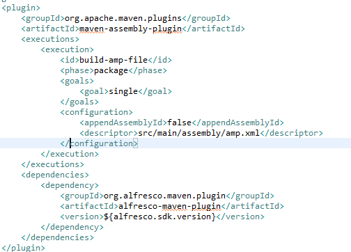

sorry, i got an issue with images content. When i choose my custom theme i don't see logo on the site page, login page etc...
I don't have this problem with other standard theme.
I found this page :
and so i update my amp.xml like this :
I didn't change file-mapping.properties
Thx for your help

That is how I fixed it.
Have you tried to clean the browser cache?
01-25-2018 07:55 AM
Well done !! Thank you !!
