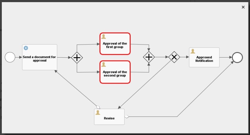

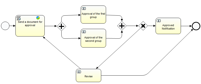

Based on the example kindly provided by Mr. Potts, I've developed the system of the contracts approval.
Business process in BPMN notation is presented below.
By Activiti Eclipse BPMN 2.0 Designer:
The scheme of a running business process in Alfresco:

Additional information: I installed exactly the same systems. On the server and on my local computer:
Alfresco Share v5.2.d (r134641-b15, Aikau 1.0.101.3,
Spring Surf 5.2.d,
Spring WebScripts 6.13,
Freemarker 2.3.20-alfresco-patched,
Rhino 1.7R4-alfresco-patched,
Yui 2.9.0-alfresco-20141223)
Alfresco Community v5.2.0 (r134428-b13) schema 10005‍‍‍‍‍‍‍‍‍‍‍‍‍‍
But it's very strange - locally everything works fine but on the server I get the same error again:
org.activiti.engine.ActivitiException: Unknown property used in expression: ${scwf_approveCount < 2}
I compared the data in the diagram and in the underlying XML and they are the same.

For creating activiti diagrams I used Activiti Eclipse BPMN 2.0 Designer 5.18. Here is a description of the process that was generated by this plug-in:
<definitions xmlns="http://www.omg.org/spec/BPMN/20100524/MODEL" xmlns:xsi="http://www.w3.org/2001/XMLSchema-instance" xmlns:xsd="http://www.w3.org/2001/XMLSchema" xmlns:activiti="http://activiti.org/bpmn" xmlns:bpmndi="http://www.omg.org/spec/BPMN/20100524/DI" xmlns:omgdc="http://www.omg.org/spec/DD/20100524/DC" xmlns:omgdi="http://www.omg.org/spec/DD/20100524/DI" typeLanguage="http://www.w3.org/2001/XMLSchema" expressionLanguage="http://www.w3.org/1999/XPath" targetNamespace="http://www.activiti.org/test">
  <process id="contractsApproval" name="Contracts Approval" isExecutable="true">
