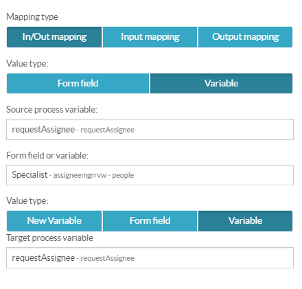

For additional reference, I'm using form mappings to set the value of the analyst in the manager form:

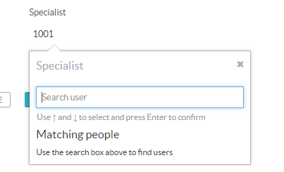

When the manager form is displayed, the id shows in the People control instead of the name:
