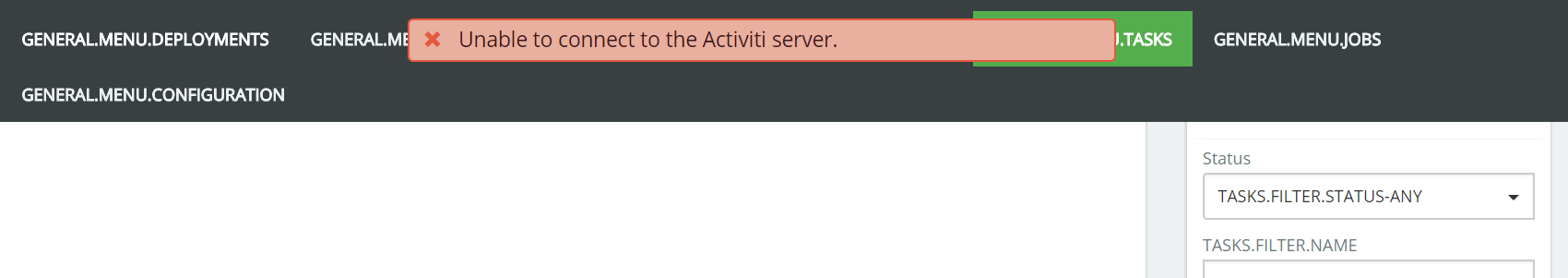

The admin and rest api seem unoperational though, I can login on both width default credentials, but the admin displays an error and translation keys are not translated.

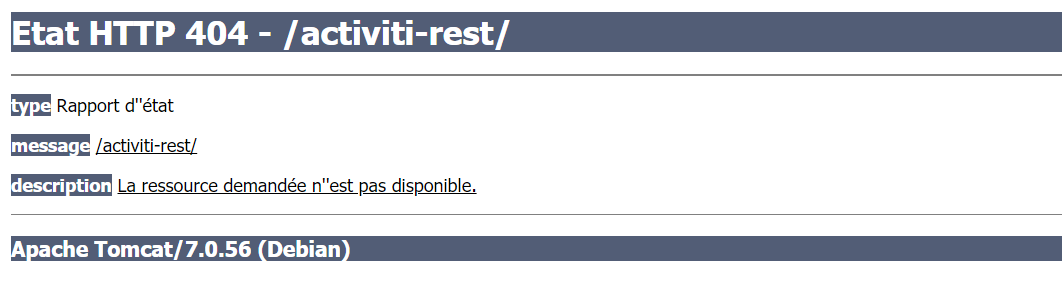

The REST api displays 404 after successful login.
Here's what seems to be a relevant extract from the output of tomcat :
[http-bio-8080-exec-2] ERROR com.activiti.service.activiti.ActivitiClientService - Error executing request to uri http://localhost:9999/activiti-app/api/query/historic-process-instances?size=25&sort=processInstance...
org.apache.http.conn.HttpHostConnectException: Connect to localhost:9999 [localhost/127.0.0.1] failed: Connection refused (Connection refused)
I think that it tries (wrongly) to contact the REST api via port 9999 (which I btw updated in the admin conf file for 8080, not sure if it's correct).
