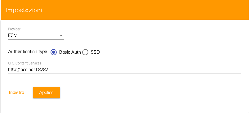

Modify the file " alfresco-ng2-components/demo-shell/src/app.config.json"
"$schema": "../../lib/core/app-config/schema.json",
"ecmHost": "http://localhost:8282",
"bpmHost": "http://localhost:9999", //NOT USED

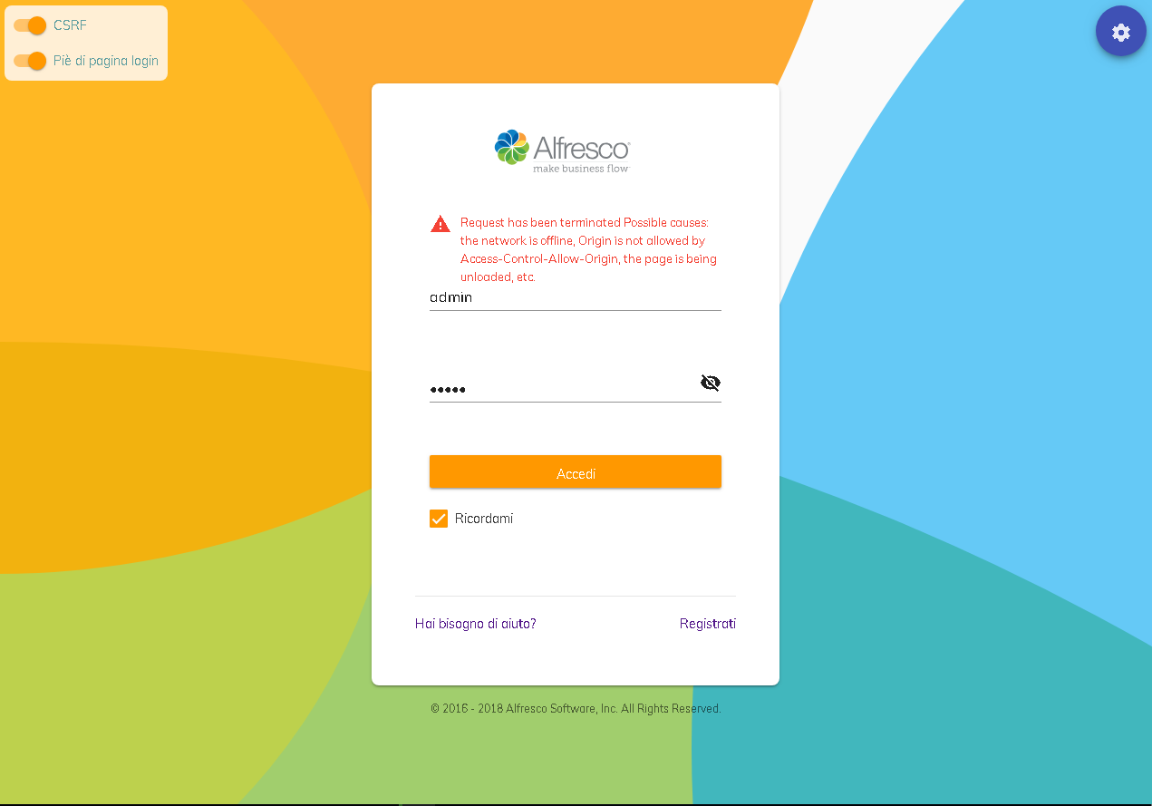

After that i run "npm install" and "npm run" and the application popup on the browser on the port 3000, but i can't figure out why i keep telling me the error:
"Request has been terminated Possible causes: the network is offline, Origin is not allowed by Access-Control-Allow-Origin, the page is being unloaded, etc."
I try everything to solve the issue but without any result .

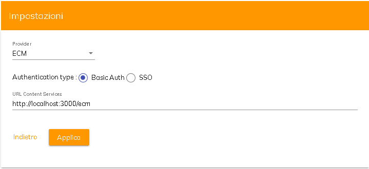

"ecmHost": "http://localhost:3000/ecm",
"bpmHost": "http://localhost:3000/bpm", //NOT USED
"application": {
"name": "Alfresco ADF Application"
And modify the "alfresco-ng2-components/lib/config/webpack.common.js" by adding these piece of code:

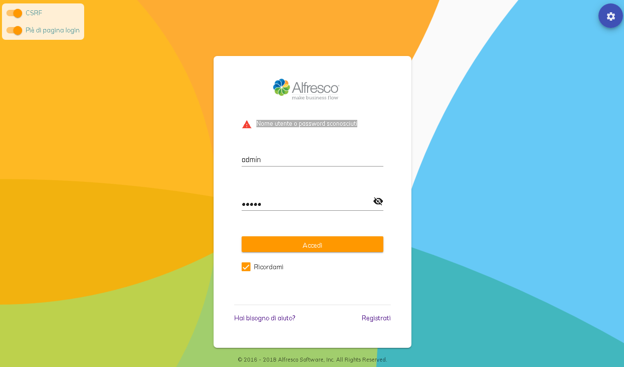

Now i get another error : "Username and password unknows"
And now i'm stuck.
