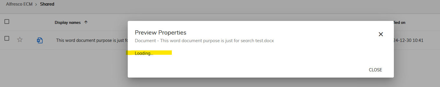

we are using alfresco 7.3.1, and using ADF UI, all was working fine few days back, but now we see, document properties preview/ Edit properties actions not at all loading. It shows popup but loading infinitely.

as you are using ACS Enterprise, open a case at Hyland support portal, https://community.hyland.com/
In any case, SOLR is not involved in document previews, so the two issue are not related.
The SOLR error is about node with ID 875, you should check the node with the node browser and investigate why it's not indexable
For the ADF doc preview, check the alfresco.log and the browser's Developer tools to see if there's some Error
