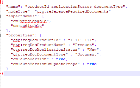

Hi Gavin!
Is it possible to create node of sys:base class?
I got an error:
The request is:
I have requested post /nodes/{nodeId}/children
otp:referenceRequiredDocuments is :
{nodeId} is folder (cm:folder class):

No, as the error message says it's only possible to create sub-types of cm:cmobject via the REST API at this time.
The "sys" namespace is reserved for system level objects that should generally remain hidden from APIs/UIs.  Is there a reason you need to extend from sys:base? I would recommend extending from cm:cmobject.

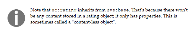

Hello, Gavin.
We used inherit from sys:base according to book alfresco developers guide 5.0 ((
Can we change parent class of our objects from sys:base to cm:cmobject after production system start?
