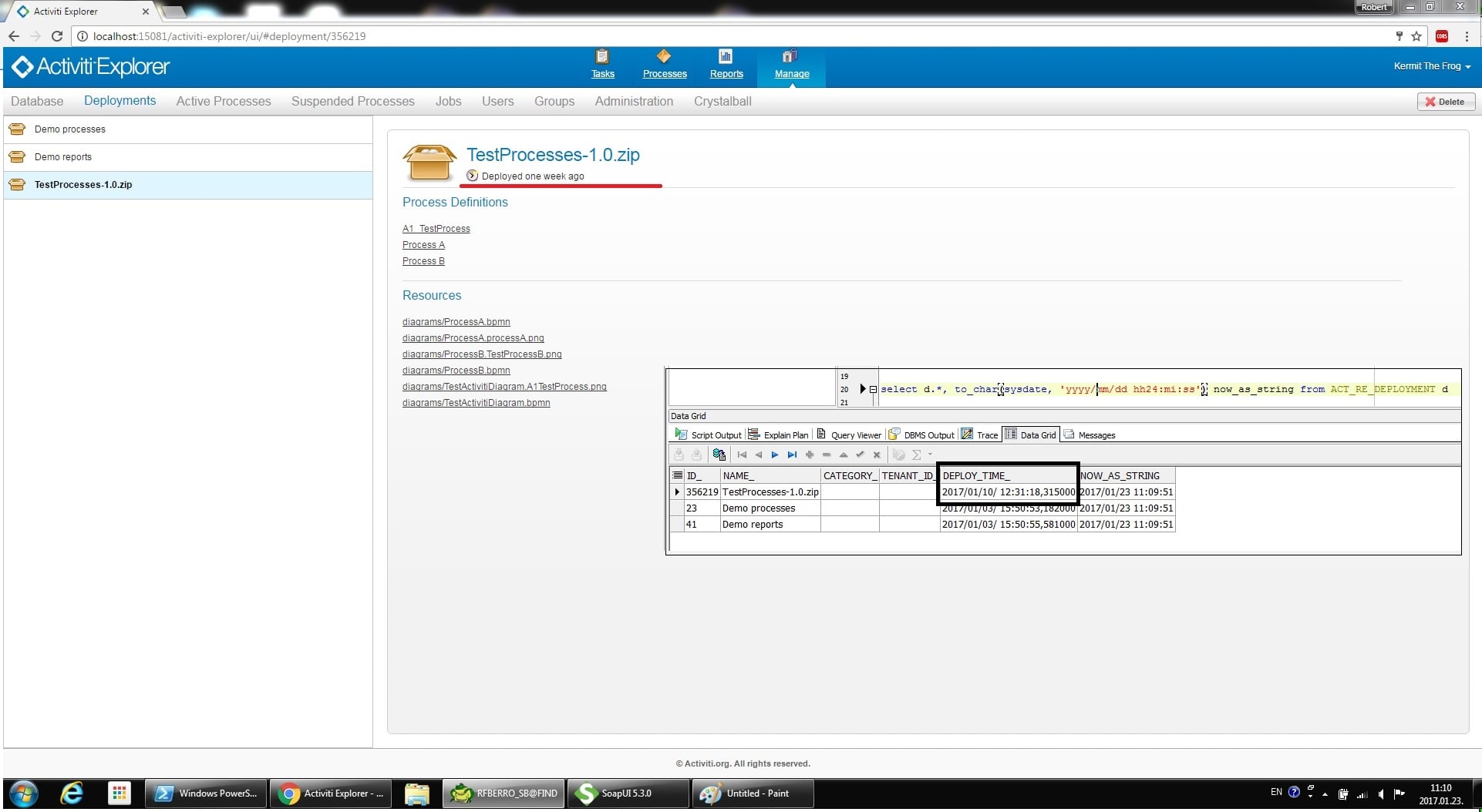

I experience this strange product behavior, quite critical thing i must admit. The processes i am deploying via activiti explorer are getting wrong deployment date. And what is more crucial - instance actions also randomly gets wrong start_time_ and end_time_.
Well, with a deployment i can replicate it quite easily. I just go to activiti admin (logged as  kermit_ and deploy my test processes. (Screenshot attached. You can see in a screen shot that OS date and time as well as DB date and time are fine). With instance actions i have not found a straight path to replicate, it is just happening, and it is a complete stopper to use the product, since it is not possible to analyze when the action happened.
Maybe somebody can assist me with a solution. Hope it's kind of configuration or something...
thank you in advance!
activit 5.22.0
db oracle 11g
app server: (wildfly) Jboss eap 7.0.0.GA
os jboss running on - windows 7 pro
deploying processes
deployed wrong date
11 REPLIES 11

vipi_voxa
Champ in-the-making
Champ in-the-making
Guys thank you at looking at this!
well, just to make it absolutely clear, the new deployment is successfully deployed. Before the deployment of the new process there are no similar deployments deployed (you probably can notice it in the deployment list on the first screenshot, left side - list of deployments consist only of demo reports and demo processes).
Table act_re_deployment does not hold any records about the new deployment on the moment of the deployment. I hope it is clear enough now.
After new deployment is done, the record appears in act_re_deployment not only with the wrong date but with the wrong time as well (date is in a past).
Can you please guide me a of how to create a test case for this scenario? I can replicate it every time i deploy any process.

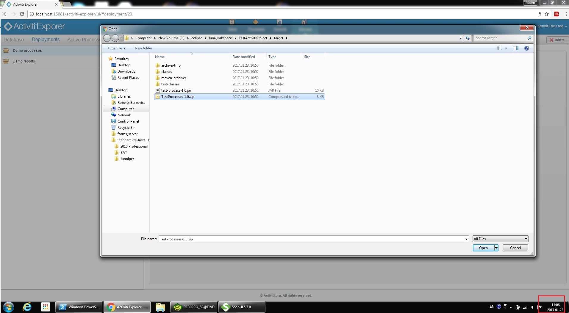

Hi Greg,
Please find the answers below.
1. I am deploying with activiti-explorer-> manage->deployments->upload new
2. UTC+02:00
3. app. server is running on my PC
4. DB OS is: EET,
SELECT EXTRACT(TIMEZONE_HOUR FROM SYSTIMESTAMP)
FROM dual;
2

System.out.println( 'getting timezone processEngineConfiguration done.')‍‍‍‍‍‍‍‍‍‍‍
and the output i get in a console:
[Server:common-server] 26 janv. 2017 06:03:48,320 [default task-4] INFO stdout - getting timezone processEngineConfiguration...
[Server:common-server] 26 janv. 2017 06:03:48,323 [default task-4] INFO stdout - timeZone: Eastern European Time
[Server:common-server] 26 janv. 2017 06:03:48,323 [default task-4] INFO stdout - lFormatedDate: 01/15/2017 17:24:43
[Server:common-server] 26 janv. 2017 06:03:48,324 [default task-4] INFO stdout - getting timezone processEngineConfiguration done.‍‍‍‍‍‍‍‍‍‍‍‍‍‍
and further down in the log i can see all this updates to database process execution is making with that wrong 01/15/2017 date Smiley Sad :
[Server:common-server] 26 janv. 2017 06:03:48,366 [default task-4] DEBUG org.activiti.engine.impl.db.DbSqlSession - insert Sun Jan 15 17:24:43 EET 2017 : PROCESSINSTANCE_START
[Server:common-server] 26 janv. 2017 06:03:48,366 [default task-4] DEBUG org.activiti.engine.impl.db.DbSqlSession - insert Sun Jan 15 17:24:43 EET 2017 : ACTIVITY_STARTED
[Server:common-server] 26 janv. 2017 06:03:48,366 [default task-4] DEBUG org.activiti.engine.impl.db.DbSqlSession - insert Sun Jan 15 17:24:43 EET 2017 : ACTIVITY_COMPLETED
[Server:common-server] 26 janv. 2017 06:03:48,366 [default task-4] DEBUG org.activiti.engine.impl.db.DbSqlSession - insert Sun Jan 15 17:24:43 EET 2017 : SEQUENCEFLOW_TAKEN
[Server:common-server] 26 janv. 2017 06:03:48,366 [default task-4] DEBUG org.activiti.engine.impl.db.DbSqlSession - insert Sun Jan 15 17:24:43 EET 2017 : ACTIVITY_COMPLETED‍‍‍‍‍‍
Please guide me where this 01/15/2017 is coming from? what am i doing wrong?
Thank you!
