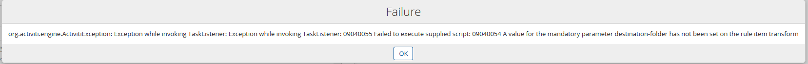

Afterwards I tested to see if emails were sent out but not as of yet. After I restarted the VM to see if that might help, I got a new error when testing the workflow after pressing Approve or Reject:
I since have removed the added lines and undid changes mentioned above. I have also restarted the VM but still end up with this error.

That error is completely unrelated to the email / invite notification configuration. You apparently have some rule / action configured somewhere that gets directly / indirectly triggered by a listener in a custom process (none of the default processes to anything with content), and the rule / action triggered is missing a parameter (or the parameter contains a NodeRef that is now invalid due to the node having been deleted since).

This has nothing to do with your alfresco-global.properties. You have a rule configured in the repository (on a node / folder somewhere) which contains an action (i.e. copy / move-to) which points to a folder that may have been deleted. It is impossible for me to tell where you might find this configuration without knowing your repository layout, the detail message / stacktrace of your error (potentially found in alfresco.log or via the browser developer tools in the "network" section) or any idea which folder your custom workflow may be touching. If you have not configured / developed the custom workflow or set up any copy / move-to related rules anywhere in the repository, you may need to find the person that did, unless you can find sufficient information in the logs to help you identify the source (or anyone here if you can share the logs).

I have pulled the log file Alfresco.log but I can't spot anything that would indicate an error there. On a side note I created task with the default option and not the customs ones but each of them gave the same error.
Here's the Alfresco.log file I pulled, please do let me know if there is something I can add to make the situation more helpful:
10-22-2018 04:21 AM
Yeah, apparently the rule error is not being reported to the log, which is too bad. Looking at the code I don't see any other way to pinpoint the root cause other than doing a live-debugging of the service using an IDE's integrated remote debugger...
