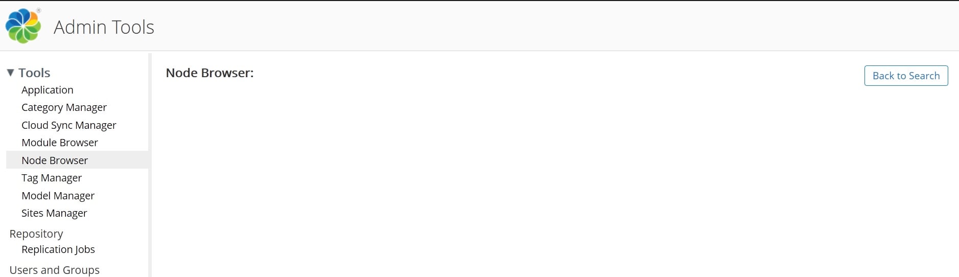

I tried accessing the node which was imported through the Bulk Importer tool and the node browser did not render it.

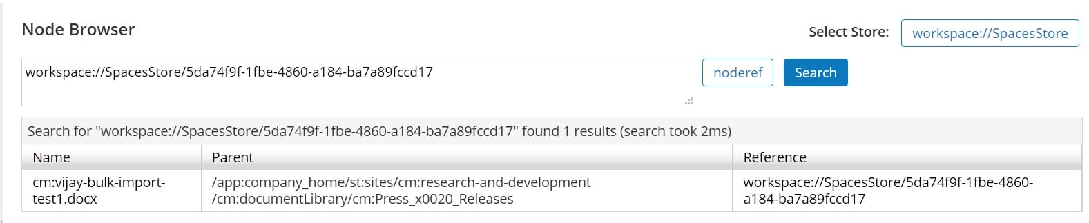

I searched for the node and it showed up as below:
When I click on the node, I see the below screen:

I am not quite sure why it does not render properly on Node Browser, I want to fix this as it would help in future debugging purposes.
