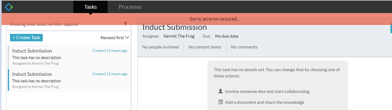

There is one urgent issue.. I am trying to hit the Activiti REST call to start the Process Instance. When I hit the Process Instance, it shows that the instance is created and task is assigned to next user. But No form is displayed and it shows error in the page as below.

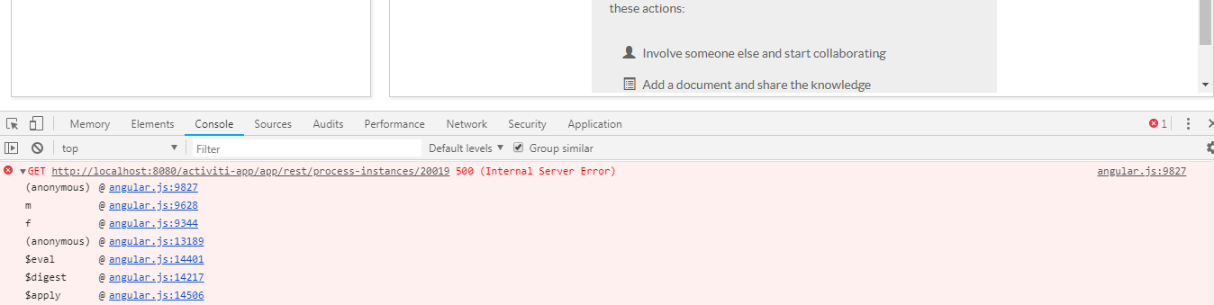

Error Screen shots

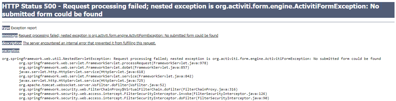

And I took the URL from the console and tried to hit it.. It shows the below error:
HTTP Status 500 - Request processing failed; nested exception is org.activiti.form.engine.ActivitiFormException: No submitted form could be found

08-16-2018 06:15 AM
There is a internal server error can you please attach the response of an api in the above image. That will be a server error logs..
