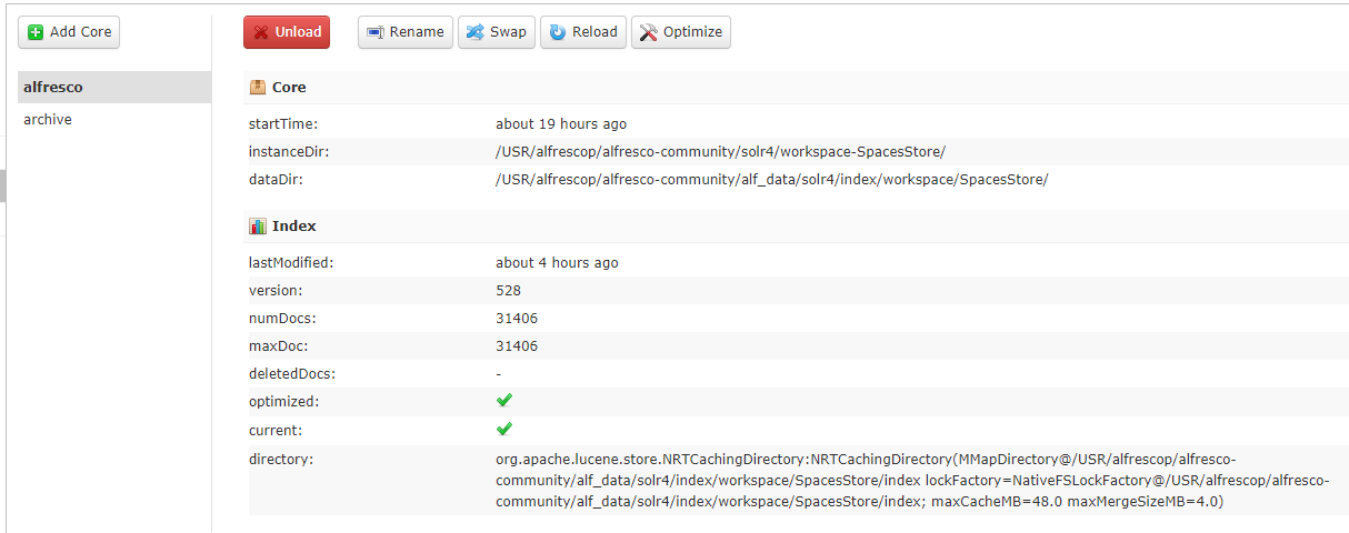

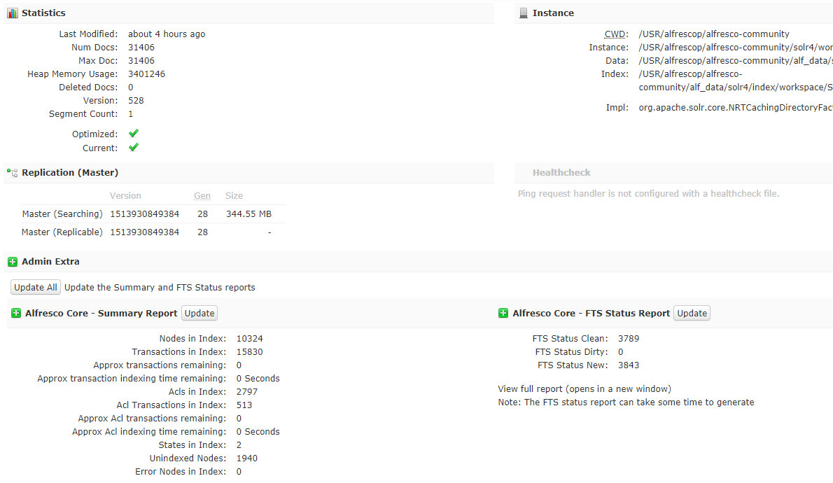

After the startup, Alfresco Share interface is OK with all functionnality. My problem occur when I add or modify a file, the file is well added in the interface but it seem not indexed, is never added in "recently updated/modified" category , recents and searching actions (rss functions..).
If I check Solr admin console, i notice that lastModified value is never updated and there are no log in catalina.out or solr.log) ...

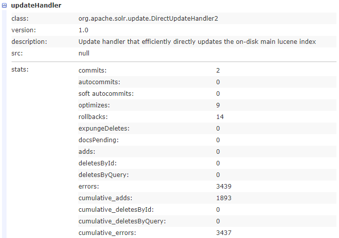

UpdateHandler details :

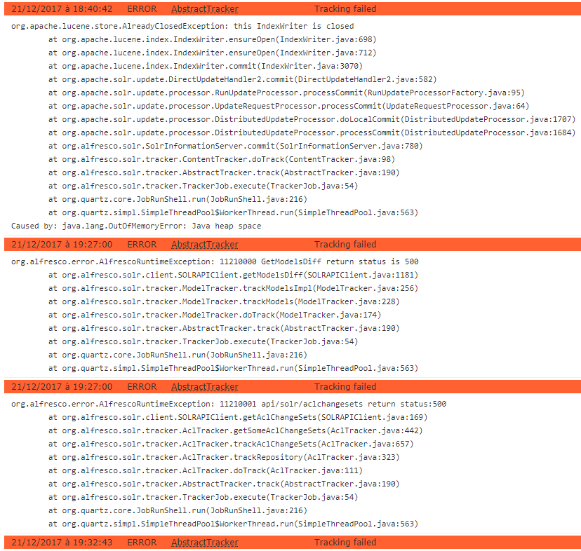

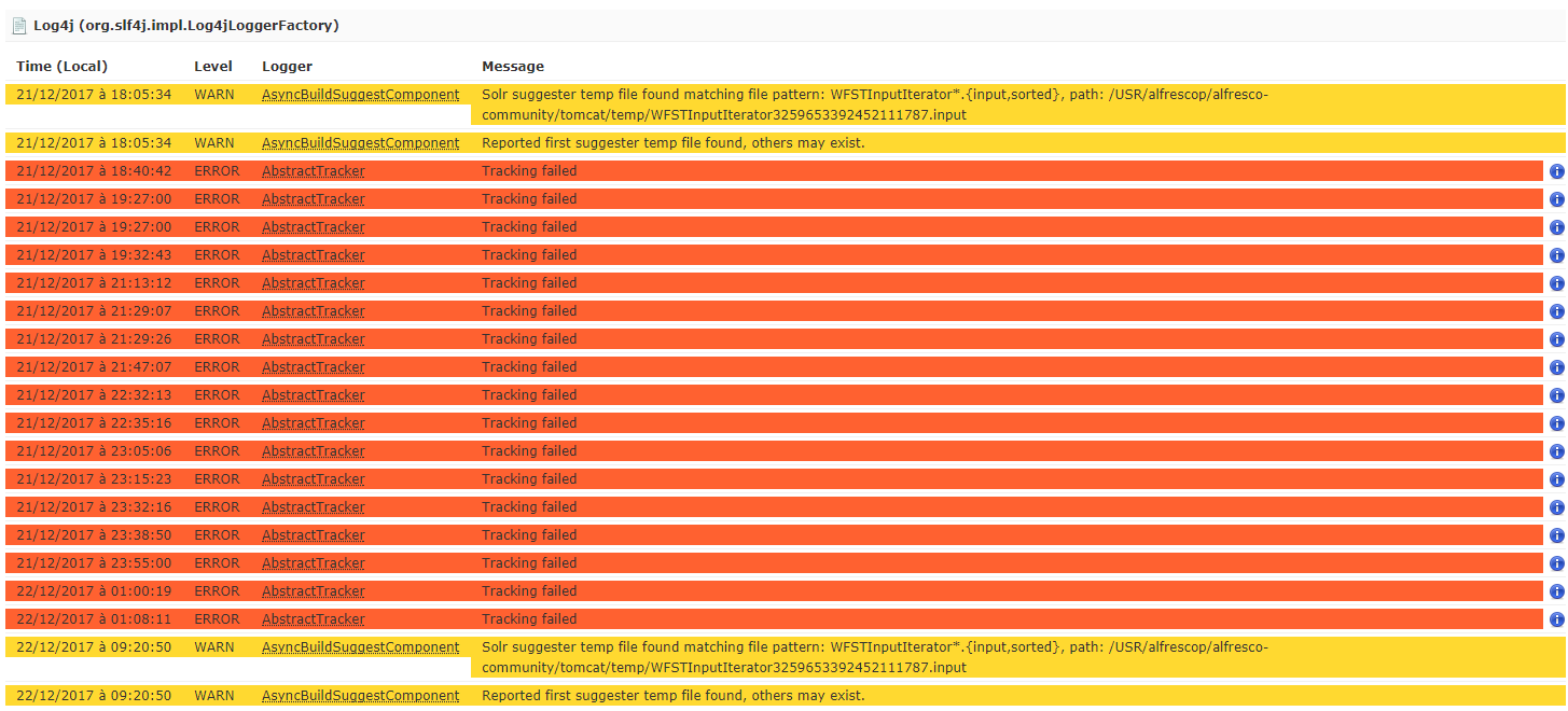

In SolrR logging console , I found some errors after startup at ~16:00
For "Java heap space" message I already increase JAVA_OPTS values in setenv.sh like this

You apparently have an error on the Repository side (logs not provided), which is indicated by SOLR receiving a 500 response code for its calls to the APIs to retrieve index-relevant changes. Check the alfresco.log file for any issues, correct them, and try again.
If you included the SOLR log file as an attachement (along with alfresco.log) instead of a short excerpt screenshot, people on this platform could potentially help you out more effectively.

At first sight, you have an Out of Memory Error in your logs (both alfresco.log and solr.log), so your instance is not starting properly. Try increasing your RAM and JVM Heap resources (in setenv.sh)
Caused by: java.lang.OutOfMemoryError: Java heap space
In addition, are you sure that the above JVM settings are being applied properly ? (-Xms4G -Xmx5G) For example, if some other heap values are included via JAVA_OPTS in tomcat/scripts/ctl.sh script or in service startup script. You may check this with ps command.
