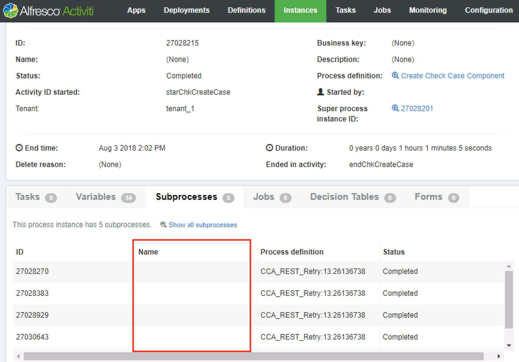

I have a Process Definition that makes a number of different calls to a subprocess via Call Activity, as the subprocess is called multiple times for many different reasons, I'd like to be able to set the 'Name' for each instance of the called subprocess, so that name gets displayed on the Admin Console - see screen shot
I tried setting a Java Listener to modify the name e.g. and setting it as a start event in the subprocess, but that does not seem to take any effect. I also tried a script based listener doing similar, but again the name does not seem to get set.
We are using Alfresco Activiti Enterprise BPM Suite v1.5.0

And interestingly, this seems to correctly set the value into the ACT_HI_PROCINST table for the called process, I can run a SQL query to check (see screenshot below). However the value still does not appear in the Admin App UI

Admin UI for parent process
Admin UI for Called Process

08-07-2018 05:53 AM
It works fine on 1.9 could be an issue with the admin app UI that was fixed post to 1.5.
Does the REST API return the process instance name?
