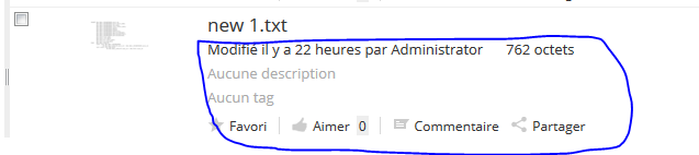

I am working on a mock-up and come up with the following issue:
I would like to replace the default metadata in the document library with the custom properties, appr. 6 of them
The content model is working fine, properties are displayed when document details are dispalyed
Is there a way to achieve this?
Currently using Alfresco Community Edition 5.2 (all-in-one)
Thanks alot for your help,
Zsolt Putnoky

Thanks for your reply. I have checked the tutorial already. My issue is that as this is a mock-up I do not have the full development environment in place. I tried to achieve this by modifying XML files.
Here is the tutorial I used today:
https://marcelloborsetto.wordpress.com/2013/07/04/show-custom-metadata-in-alfresco-file-list/
I guess you will understand more than I do as I do not speak Italian at all (guess you do). So, did the tutorial, catalina out is okay, no error message, but no property displayed. My main issue was/is that I do not know where to specify the content type in the code examples.
I added the code into the share-documentlibrary-config.xml as I thought this is the file rendering the view. I will try to add it to the file you mentioned.

Solved the issue! Did a typo. Now I need to figure out how to display more than one property in the same line, then all is good for this issue.
