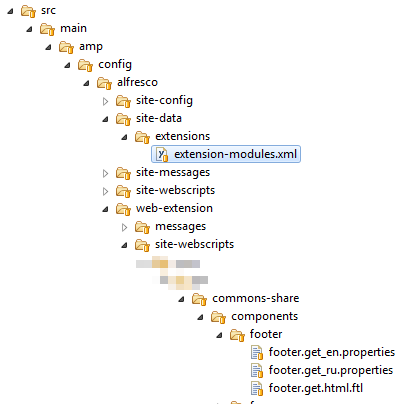

I've already replaced footer on other pages with custom one (by defining extension on src/main/amp/config/alfresco/site-data/extensions), but seems like it doesn't affect footer on faceted-search page. How can I customize this footer? Should I define another extension or I can somehow use existing one?
On the image are my extension files (+ css in .../web/components/footer).
And footer.get.html.ftl

If you search for "faceted search footer" on this platform, the second result is a 2-year old question about the same topic that has already been replied too. You need to perform modify the JSON model of the page by using a Surf extension module with a post-processor JavaScript controller on the faceted-search.get web script. The footer.get.html.ftl will only work for the "old", non-Aikau footer in hybrid or full YUI pages. But faceted-search is a full-Aikau page without the global footer component.
