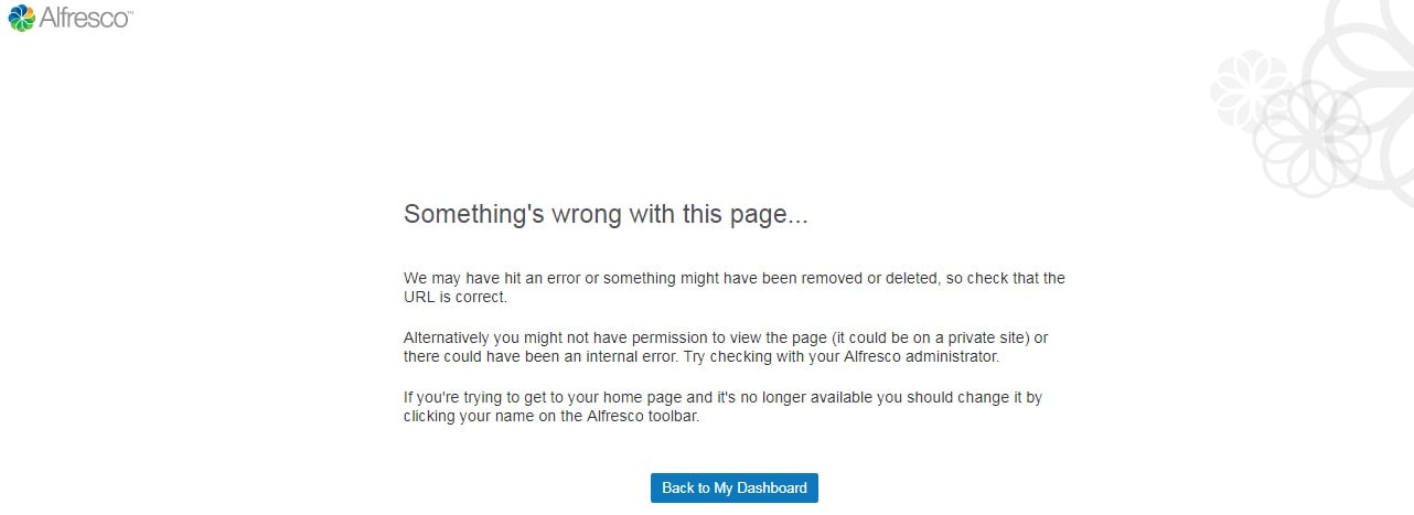

Hey guys, Can anyone tell why I'm getting this problem(in attached image). Some people suggested and they've solved this problem by adding the below code, I couldn't get to which file i should place the below code.
ProxyPreserveHost On
ProxyRequests Off
Help me out guys.. i stuck here from past 2 weeks.
(Please mention the filename and the path)
Thnx in advance..

Hello.
That image alone is not enough to identify what is wrong.
Check the log files (alfresco.log, catalina.out, share.log) and give us more details.

All the 3 log files are attached in below link.. FYI.
Let me know if you require some more files..

You have a clear error message in the log:
Caused by: org.springframework.extensions.surf.exception.PlatformRuntimeException: 09240000 No 'login' page type configured - but page auth required it.
It would be good to know what general changes you have made to the Alfresco Share application. Out-of-the-box you will never have this kind of an error, so you must have changed some configuration, deleted some files / build the share.war in some funny way, or installed an addon that messes with some things.

Hello
I got the same error. On a Windows 10 platform. http://127.0.0.1:8080/share/page/ page gives the error. In the share file there is the following log. I did not change any thing.
2017-12-02 17:02:22,339 ERROR [org.springframework.extensions.surf.render.RenderService] [http-apr-8080-exec-2] An exception occurred while rendering: slingshot-login
org.springframework.extensions.surf.exception.RendererExecutionException: Cannot resolve template - may be missing from the definition: template-instance: simple-guest, <?xml version="1.0" encoding="UTF-8"?>
Alfresco info :
