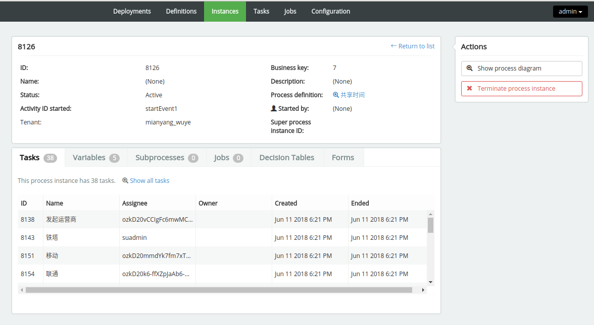

I finished all task , but this Process Instance did't  change it status to complete

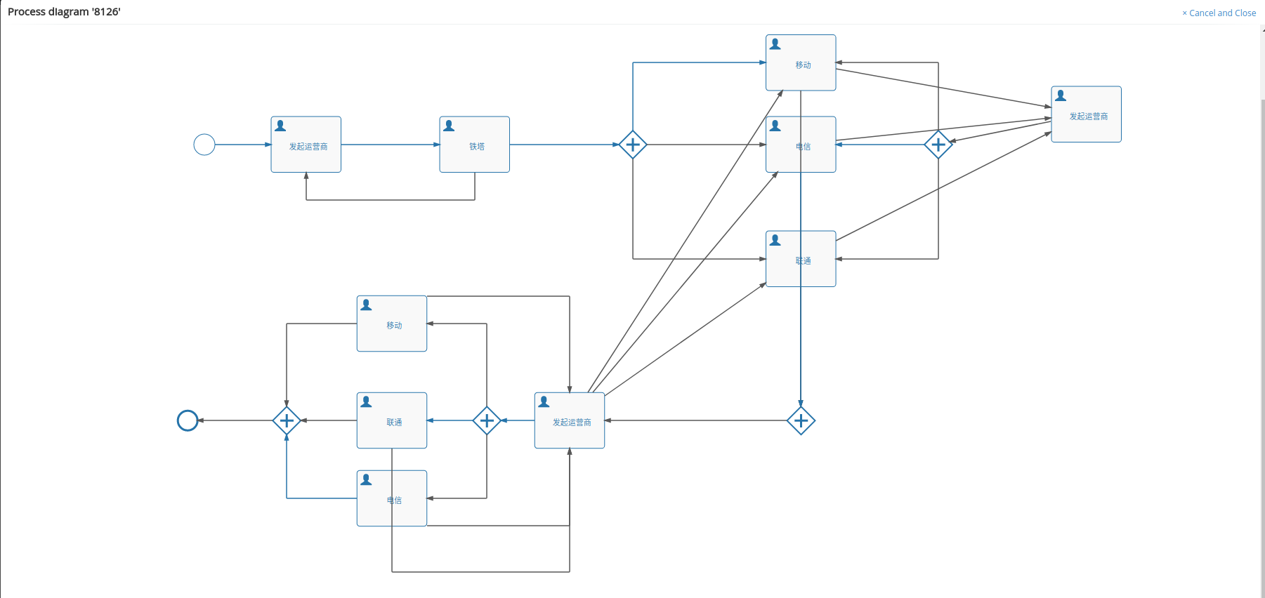

flow img:

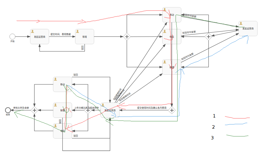

replay:
1 push this process, claim and complete task but keep last task
2 compete task with reject , push process to the right node.
3  Continue pushing and complete all tasks
my terrible picture:
Note:
The bpmn file include many important info and this a very complex flow. Even I used "skipExpression".
I am sure i finished all tasks, but process did't change it status.
If I'm not through step 2( the blue line), just finished last task, and the process works well.

it might be the last gateway that it is holding the execution?
Notice that you have a parallel gateway, so you need to finish all three tasks in order to move the process to a completed state.

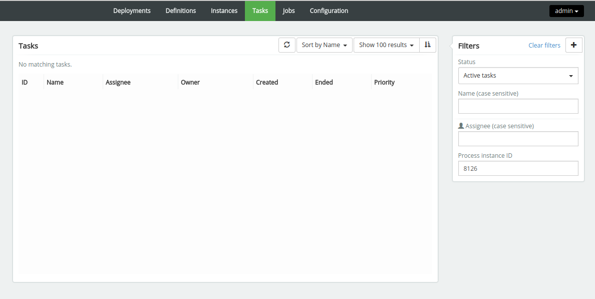

I checked all the tasks again. I'm sure that there are no tasks left.
Look at here:

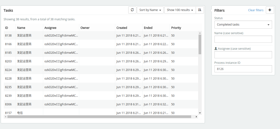

my task histories:
```json

"variables": [],
"tenantId": "mianyang_wuye",
"category": null
"id": "8193",
"processDefinitionId": "share_time:3:8010",
"processDefinitionUrl": "http://activiti.dev.mytower.cn/repository/process-definitions/share_time:3:8010",
"processInstanceId": "8126",
"processInstanceUrl": "http://activiti.dev.mytower.cn/history/historic-process-instances/8126",
"executionId": "8148",
"name": "联通",
"description": null,
"deleteReason": null,
"owner": null,
"assignee": "ozkD20k6-ffXZpJaAb6-MJdVLZOw",
"startTime": "2018-06-11T18:26:41.954+08:00",
"endTime": "2018-06-11T18:29:48.831+08:00",
"durationInMillis": 186877,
"workTimeInMillis": 61,
"claimTime": "2018-06-11T18:29:48.770+08:00",
"taskDefinitionKey": "sid-098624D6-DAF9-4D96-91A9-546E07107A98",
"formKey": null,
"priority": 50,
"dueDate": null,
"parentTaskId": null,
"url": "http://activiti.dev.mytower.cn/history/historic-task-instances/8193",
"variables": [],
"category": null
"id": "8196",
"executionId": "8190",
"name": "移动",
"owner": null,
"assignee": "ozkD20mmdYk7fm7xTHEMuG7VPQiE",
"startTime": "2018-06-11T18:26:41.955+08:00",
"endTime": "2018-06-11T18:31:35.898+08:00",
"durationInMillis": 293943,
"claimTime": "2018-06-11T18:31:35.837+08:00",
"taskDefinitionKey": "sid-8805CFC0-920D-4D1B-B97B-9B30EB56B2E3",
"formKey": null,
"priority": 50,
"dueDate": null,
"url": "http://activiti.dev.mytower.cn/history/historic-task-instances/8196",
"variables": [],
"category": null
"id": "8199",
"executionId": "8191",
"name": "电信",
"owner": null,
"assignee": null,
"startTime": "2018-06-11T18:26:41.956+08:00",
"endTime": "2018-06-11T18:26:41.959+08:00",
"durationInMillis": 3,
"workTimeInMillis": null,
"claimTime": null,
"taskDefinitionKey": "sid-37050443-7778-4AD4-A58F-49DFC435A934",
"formKey": null,
"priority": 50,
"dueDate": null,
"url": "http://activiti.dev.mytower.cn/history/historic-task-instances/8199",
"variables": [],
"category": null
"id": "8203",
"executionId": "8200",
"name": "发起运营商",
"owner": null,
"assignee": "ozkD20vCCIgFc6mwMCnEDj0by1zY",
"startTime": "2018-06-11T18:26:41.961+08:00",
"endTime": "2018-06-11T18:29:21.496+08:00",
"durationInMillis": 159535,
"workTimeInMillis": 50,
"claimTime": "2018-06-11T18:29:21.446+08:00",
"taskDefinitionKey": "sid-EF67DF36-B82E-4215-A7A2-FF1C8565887B",
"formKey": null,
"priority": 50,
"dueDate": null,
"url": "http://activiti.dev.mytower.cn/history/historic-task-instances/8203",
"variables": [],
"category": null
"id": "8209",
"executionId": "8206",
"name": "联通",
"owner": null,
"startTime": "2018-06-11T18:29:21.500+08:00",
"endTime": "2018-06-11T18:29:49.031+08:00",
"durationInMillis": 27531,
"workTimeInMillis": 77,
"claimTime": "2018-06-11T18:29:48.954+08:00",
"taskDefinitionKey": "sid-8C02BC90-02E7-40D4-8709-D2C7506CAFC1",
"formKey": null,
"priority": 50,
"dueDate": null,
"url": "http://activiti.dev.mytower.cn/history/historic-task-instances/8209",
"variables": [],
"category": null
"id": "8214",
"name": "联通",
"owner": null,
"startTime": "2018-06-11T18:29:21.503+08:00",
"endTime": "2018-06-11T18:29:49.156+08:00",
"durationInMillis": 27653,
"workTimeInMillis": 57,
"claimTime": "2018-06-11T18:29:49.099+08:00",
"formKey": null,
"priority": 50,
"dueDate": null,
"url": "http://activiti.dev.mytower.cn/history/historic-task-instances/8214",
"variables": [],
"category": null
"id": "8217",
"executionId": "8211",
"name": "移动",
"owner": null,
"startTime": "2018-06-11T18:29:21.504+08:00",
"endTime": "2018-06-11T18:31:35.997+08:00",
"durationInMillis": 134493,
"claimTime": "2018-06-11T18:31:35.947+08:00",
"formKey": null,
"priority": 50,
"dueDate": null,
"url": "http://activiti.dev.mytower.cn/history/historic-task-instances/8217",
"variables": [],
"category": null
"id": "8220",
"executionId": "8212",
"name": "电信",
"owner": null,
"assignee": null,
"startTime": "2018-06-11T18:29:21.505+08:00",
"endTime": "2018-06-11T18:29:21.508+08:00",
"claimTime": null,
"formKey": null,
"priority": 50,
"dueDate": null,
"url": "http://activiti.dev.mytower.cn/history/historic-task-instances/8220",
"variables": [],
"category": null
"id": "8224",
"executionId": "8221",
"name": "发起运营商",
"owner": null,
"startTime": "2018-06-11T18:29:21.510+08:00",
"endTime": "2018-06-11T18:30:48.842+08:00",
"durationInMillis": 87332,
"workTimeInMillis": 55,
"claimTime": "2018-06-11T18:30:48.787+08:00",
"formKey": null,
"priority": 50,
"dueDate": null,
"url": "http://activiti.dev.mytower.cn/history/historic-task-instances/8224",
"variables": [],
"category": null
"id": "8228",
"name": "发起运营商",
"owner": null,
"startTime": "2018-06-11T18:29:48.834+08:00",
"endTime": "2018-06-11T18:30:48.938+08:00",
"durationInMillis": 60104,
"workTimeInMillis": 37,
"claimTime": "2018-06-11T18:30:48.901+08:00",
"formKey": null,
"priority": 50,
"dueDate": null,
"url": "http://activiti.dev.mytower.cn/history/historic-task-instances/8228",
"variables": [],
"category": null
"id": "8235",
"executionId": "8232",
"name": "发起运营商",
"owner": null,
"startTime": "2018-06-11T18:29:49.035+08:00",
"endTime": "2018-06-11T18:30:49.091+08:00",
"durationInMillis": 60056,
"workTimeInMillis": 45,
"claimTime": "2018-06-11T18:30:49.046+08:00",
"taskDefinitionKey": "sid-C0B77EFD-2A8C-4653-9504-E73E03FA8A68",
"formKey": null,
"priority": 50,
"dueDate": null,
"url": "http://activiti.dev.mytower.cn/history/historic-task-instances/8235",
"variables": [],
"category": null
"id": "8239",
"name": "发起运营商",
"owner": null,
"startTime": "2018-06-11T18:29:49.158+08:00",
"endTime": "2018-06-11T18:30:49.238+08:00",
"durationInMillis": 60080,
"workTimeInMillis": 39,
"claimTime": "2018-06-11T18:30:49.199+08:00",
"formKey": null,
"priority": 50,
"dueDate": null,
"url": "http://activiti.dev.mytower.cn/history/historic-task-instances/8239",
"variables": [],
"category": null
"id": "8246",
"name": "联通",
"owner": null,
"startTime": "2018-06-11T18:30:48.847+08:00",
"endTime": "2018-06-11T18:31:46.895+08:00",
"durationInMillis": 58048,
"workTimeInMillis": 43,
"claimTime": "2018-06-11T18:31:46.852+08:00",
"formKey": null,
"priority": 50,
"dueDate": null,
"url": "http://activiti.dev.mytower.cn/history/historic-task-instances/8246",
"variables": [],
"category": null
"id": "8249",
"executionId": "8243",
"name": "移动",
"owner": null,
"startTime": "2018-06-11T18:30:48.848+08:00",
"endTime": "2018-06-11T18:31:36.125+08:00",
"durationInMillis": 47277,
"workTimeInMillis": 47,
"claimTime": "2018-06-11T18:31:36.078+08:00",
"formKey": null,
"priority": 50,
"dueDate": null,
"url": "http://activiti.dev.mytower.cn/history/historic-task-instances/8249",
"variables": [],
"category": null
"id": "8252",
"executionId": "8244",
"name": "电信",
"owner": null,
"assignee": null,
"startTime": "2018-06-11T18:30:48.849+08:00",
"endTime": "2018-06-11T18:30:48.852+08:00",
"claimTime": null,
"formKey": null,
"priority": 50,
"dueDate": null,
"url": "http://activiti.dev.mytower.cn/history/historic-task-instances/8252",
"variables": [],
"category": null
"id": "8259",
"name": "联通",
"owner": null,
"startTime": "2018-06-11T18:30:48.944+08:00",
"endTime": "2018-06-11T18:31:46.983+08:00",
"durationInMillis": 58039,
"claimTime": "2018-06-11T18:31:46.936+08:00",
"formKey": null,
"priority": 50,
"dueDate": null,
"url": "http://activiti.dev.mytower.cn/history/historic-task-instances/8259",
"variables": [],
"category": null
"id": "8262",
"executionId": "8256",
"name": "移动",
"owner": null,
"startTime": "2018-06-11T18:30:48.945+08:00",
"endTime": "2018-06-11T18:31:36.227+08:00",
"durationInMillis": 47282,
"claimTime": "2018-06-11T18:31:36.180+08:00",
"formKey": null,
"priority": 50,
"dueDate": null,
"url": "http://activiti.dev.mytower.cn/history/historic-task-instances/8262",
"variables": [],
"category": null
"id": "8265",
"executionId": "8257",
"name": "电信",
"owner": null,
"assignee": null,
"startTime": "2018-06-11T18:30:48.946+08:00",
"endTime": "2018-06-11T18:30:48.949+08:00",
"claimTime": null,
"formKey": null,
"priority": 50,
"dueDate": null,
"url": "http://activiti.dev.mytower.cn/history/historic-task-instances/8265",
"variables": [],
"category": null
"id": "8273",
"name": "电信",
"owner": null,
"assignee": null,
"startTime": "2018-06-11T18:30:49.096+08:00",
"endTime": "2018-06-11T18:30:49.099+08:00",
"claimTime": null,
"taskDefinitionKey": "sid-F6D554D9-3823-4878-9F60-67ACA378A70D",
"formKey": null,
"priority": 50,
"dueDate": null,
"url": "http://activiti.dev.mytower.cn/history/historic-task-instances/8273",
"variables": [],
"category": null
"id": "8275",
"executionId": "8270",
"name": "联通",
"owner": null,
"startTime": "2018-06-11T18:30:49.099+08:00",
"endTime": "2018-06-11T18:31:47.082+08:00",
"durationInMillis": 57983,
"workTimeInMillis": 51,
"claimTime": "2018-06-11T18:31:47.031+08:00",
"formKey": null,
"priority": 50,
"dueDate": null,
"url": "http://activiti.dev.mytower.cn/history/historic-task-instances/8275",
"variables": [],
"category": null
"id": "8278",
"executionId": "8271",
"name": "移动",
"owner": null,
"startTime": "2018-06-11T18:30:49.100+08:00",
"endTime": "2018-06-11T18:31:36.321+08:00",
"durationInMillis": 47221,
"claimTime": "2018-06-11T18:31:36.270+08:00",
"taskDefinitionKey": "sid-95DE55A9-C1FA-4AEB-A73A-14E58025CCB7",
"formKey": null,
"priority": 50,
"dueDate": null,
"url": "http://activiti.dev.mytower.cn/history/historic-task-instances/8278",
"variables": [],
"category": null
"id": "8286",
"name": "联通",
"owner": null,
"startTime": "2018-06-11T18:30:49.243+08:00",
"endTime": "2018-06-11T18:31:47.210+08:00",
"durationInMillis": 57967,
"workTimeInMillis": 54,
"claimTime": "2018-06-11T18:31:47.156+08:00",
"formKey": null,
"priority": 50,
"dueDate": null,
"url": "http://activiti.dev.mytower.cn/history/historic-task-instances/8286",
"variables": [],
"category": null
"id": "8289",
"executionId": "8283",
"name": "移动",
"owner": null,
"startTime": "2018-06-11T18:30:49.244+08:00",
"endTime": "2018-06-11T18:31:36.474+08:00",
"durationInMillis": 47230,
"claimTime": "2018-06-11T18:31:36.427+08:00",
"formKey": null,
"priority": 50,
"dueDate": null,
"url": "http://activiti.dev.mytower.cn/history/historic-task-instances/8289",
"variables": [],
"category": null
"id": "8292",
"executionId": "8284",
"name": "电信",
"owner": null,
"assignee": null,
"startTime": "2018-06-11T18:30:49.245+08:00",
"endTime": "2018-06-11T18:30:49.247+08:00",
"durationInMillis": 2,
"claimTime": null,
"formKey": null,
"priority": 50,
"dueDate": null,
"url": "http://activiti.dev.mytower.cn/history/historic-task-instances/8292",
"variables": [],
"category": null
"id": "8306",
"name": "发起运营商",
"owner": null,
"startTime": "2018-06-11T18:31:36.343+08:00",
"endTime": "2018-06-11T18:32:21.153+08:00",
"durationInMillis": 44810,
"claimTime": "2018-06-11T18:32:21.108+08:00",
"formKey": null,
"priority": 50,
"dueDate": null,
"url": "http://activiti.dev.mytower.cn/history/historic-task-instances/8306",
"variables": [],
"category": null
"id": "8324",
"name": "联通",
"owner": null,
"startTime": "2018-06-11T18:32:21.159+08:00",
"endTime": "2018-06-11T18:33:06.571+08:00",
"durationInMillis": 45412,
"claimTime": "2018-06-11T18:33:06.520+08:00",
"formKey": null,
"priority": 50,
"dueDate": null,
"url": "http://activiti.dev.mytower.cn/history/historic-task-instances/8324",
"variables": [],
"category": null
"id": "8327",
"executionId": "8321",
"name": "移动",
"owner": null,
"startTime": "2018-06-11T18:32:21.160+08:00",
"endTime": "2018-06-11T18:32:57.467+08:00",
"durationInMillis": 36307,
"workTimeInMillis": 52,
"claimTime": "2018-06-11T18:32:57.415+08:00",
"formKey": null,
"priority": 50,
"dueDate": null,
"url": "http://activiti.dev.mytower.cn/history/historic-task-instances/8327",
"variables": [],
"category": null
"id": "8330",
"executionId": "8322",
"name": "电信",
"owner": null,
"assignee": null,
"startTime": "2018-06-11T18:32:21.161+08:00",
"endTime": "2018-06-11T18:32:21.163+08:00",
"claimTime": null,
"formKey": null,
"priority": 50,
"dueDate": null,
"url": "http://activiti.dev.mytower.cn/history/historic-task-instances/8330",
"variables": [],
"category": null
