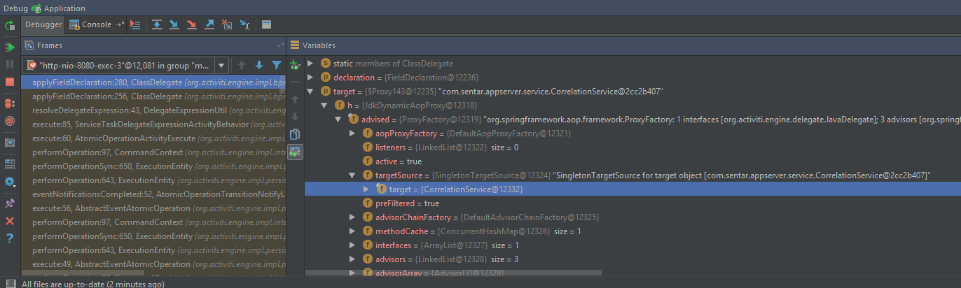

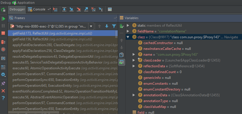

Here's a couple debug screenshots showing where the proxy is in place of the actual object:
02-24-2017 02:34 AM
02-24-2017 09:17 AM
I believe it is being proxied as part of AoP in the Spring framework. Surely Activiti is compatible with Spring? Strangely enough, a unit test using a mocked rest object seems to not cause any problems, it's only when I run the full web application that the proxy issue is arising -- perhaps an artifact of the way Spring handles unit tests, I'm really not sure. Either way, this is a pretty basic Activiti use case that it seems hard to believe wouldn't be possible in conjunction with Spring. Maybe there is some kind of configuration issue or something?
