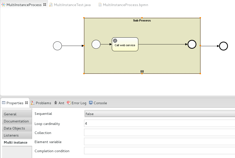

I have tried with a simple model such as below (sub process is set to be multi-instance by 4) and with the asynchronous web service call inside.
My unit test completed successfully. There were 4 instances of the sub process created. The async web service jobs were all executed without any locking exception and the instance was completed.
Here's a snippet of the logs.

If you still have issue, could you share a simple unit test to demonstrate your problem?
