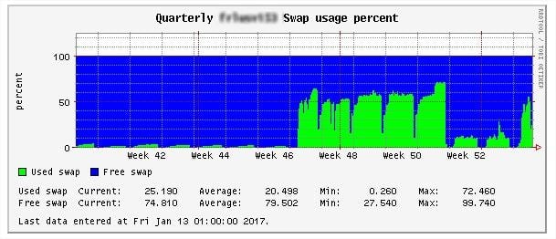

The server is under permanent heavy load since that time, and we are searching why.

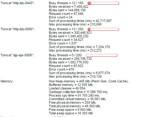

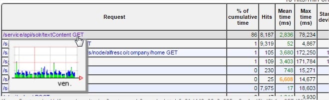

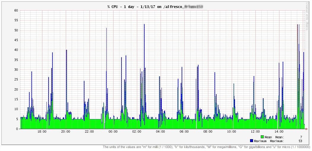

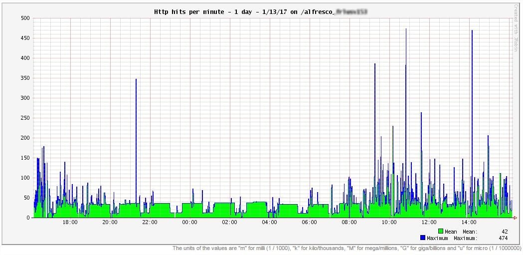

JavaMelody is deployed on that server, and we can see that the load is due to getContent calls by SOLR.
api/solr/textContent activity reported by javamelody :
When we try to reproduce what is running Alfresco, we do not succeed :
https://[servername]:8443/alfresco/service/api/solr/textContent?nodeId=420 is responding HTTP Status 403 - X509 Authentication failure.
There is no log in catalina.out for this call.
When we run the same query on the test system we get the correct answer.
But we can’t find why this GET is not working !
We don’t find any other check in order to solve this issue, any help would be appreciated.

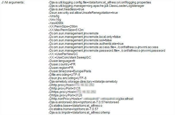

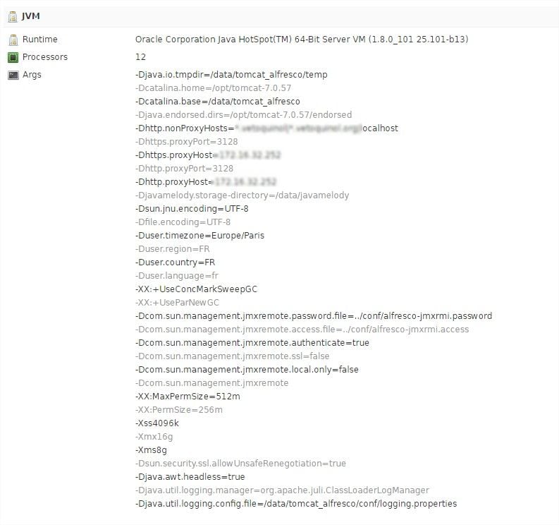

JVM arguments for Alfresco :
JVM arguments for SOLR :

Do you have some recommendation to search the reason about that heavy load ? We think this heavy load is caused by SOLR because of the number of call to textContent (/service/api/solr/textContent) which represents 86 % of the activities on the server, and the X509 Authentication failure we get when running textContent manually. We don't find any way to check why we get such X509 when running it when it seems Alfresco is able to run it because documents are content indexed. Do you have some ideas about that ?

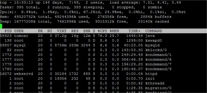

In the screenshot of top there really isn't that much CPU load on the user side - most of the load is on IO wait times which means that some storage device / filesystem level access is causing the load.
It /data/solr4 mapped to any kind of special drive / storage area? How is the general performance of that device, i.e. what is its latency / throughput rating?

The solution lies in the MySql configuration. Too many database connections was allowed consuming a lot of memory. As some free memory was missing, tomcat try to free it too often, making system starting to swap and the overall platform go to slow down. It was occuring during ~15min at a random point in the day (maybe while final users try to work a little more ?).
Decrease 'max_connections' parameter was the first good thing to do. Alfresco 'db.pool.max' parameter has to be set according ...
We found this solution based on global memory usage analyse and detailed unix process memory consumtion analyse ... it was not funny and not trivial ...
