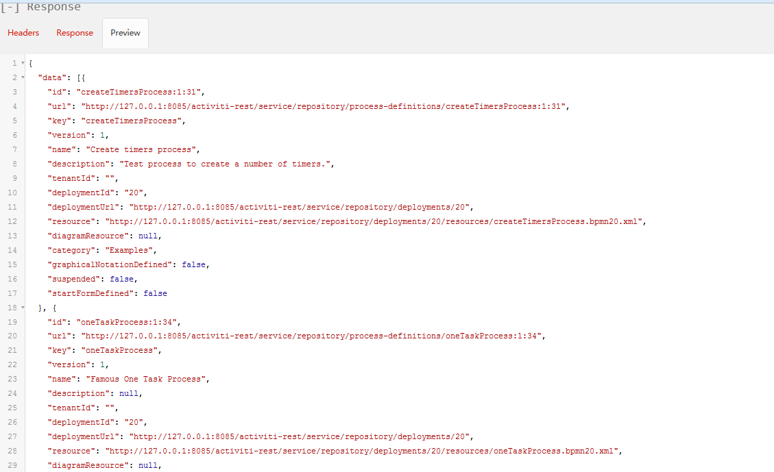

I have an issue to find out the response of a process in rest api via the rest client, which is present in Activiti-explorer of the same tomcat server.
I have the URL by which I can find out some other processes from the activiti explorer; like this -
http://127.0.0.1:8085/activiti-rest/service/repository/process-definitions?size=1000
I found the following details -
But, out of them I cannot find the process which I deployed or run from the activiti explorer.
Please let me know how to find out the id of the process required.
Thanks for the help in advance.

Yes I can see some process definitions as depicted below:
The processes above have been exposed and available when the http://127.0.0.1:8085/activiti-rest/service/repository/process-definitions?size=1000 URL is hit,
any one of the processes can be exposed by hitting the URL in the rest client : http://127.0.0.1:8085/activiti-rest/service/repository/process-definitions/createTimersProcess:1:31
One of the processes I created, deployed and ran successfully in activiti-explorer as depicted below :
But I cannot expose this process via Rest API similar to the above processes.
What should be the URL similar to http://127.0.0.1:8085/activiti-rest/service/repository/process-definitions/createTimersProcess:1:31
for the process I created to expose from Rest?
I need to know what is the URL to hit from rest client for the process running from the activiti-explorer.
Please help.

It is a list of 10-11 processes in the activiti explorer out of which only 6processes are being displayed as the response of the activiti-rest api call.
There are total 11processes present in the activiti explorer. But out of them only 6processes are getting generated as the response in the rest api. But rest (11-6)=5 processes [available in activiti explorer] are not getting generated in the rest api call. The process created by me is among those 5 processes which are present in activiti explorer but not coming in the activiti rest api.
I have the same DB configuration in db.properties file for both the activiti rest and activiti explorer as follows :
Please let me know how to connect with a database/SQL client directly to the database and to query to see what process definitions are there.
