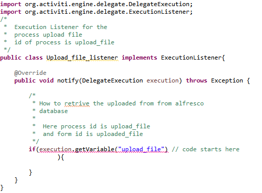

Made a process to upload a file.
Also added a execution listener to the process.
I want to know how to retrieve the uploaded file by execution listener
Below is my code for execution listener
I want to know how to get that file from database.
I want to know about java libraries to access file from database
Thank you in advance

I am doing something like this
Also how do you get the attachment id provide you know the form id
TaskService taskService = processEngine.getTaskService();
if(taskService.getAttachment("uploadurl")!=null){
InputStream attachmentStream = taskService.getAttachmentContent(attachmentId);
Here uploadurl is the form id for file upload
I think I am not doing it right
Please help
