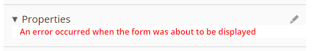

I have two extension amp files that have to be deployed since in document library there are files which are uploaded from external Alfresco sites with specific properties related to those sites and their content types/aspects. I have placed those amps in folders /amps and /amps_share but unfortunately when I try to edit those files I receive following error message in catalina.out:  Failed to create anonymous type as specified aspect
GUI error:
GUI error
One of those amps is visible in module section of admin console. Is there any step which I missed?

Thank you for your answer. Aspects from my site work fine, documents that contain my aspects can be edited and new one uploaded. The problem cause documents uploaded from external systems that also use Alfresco and have individual properties which are not part of my models.
More information related to this. First I had to upgrade system from Alfresco 4.1 to 5.2. Then I imported database and reindexed content. Everything works fine except those external documents.
As you are talking about upgrade, do you have some customization on alfresco 4.1 and have you properly upgraded in 5.2?
Yes, I do have some customizations. I have created new project using Alfresco 5.2. and implemented everything from the start, but the content model is almost the same, I have just added the new properties. After upgrade all content is imported, search works, edit properties also works but just on documents that have aspects from my model. For one of those extension amps I also created content model but nothing happens. It is not recognized. And to be honest I don't understand how external amps work.

When I upload documents in document library, aspects from content1 are added to those documents. My client has another Alfresco site e.g. called Site 2. content2 corresponds to content model from this site. My client takes documents from Site 2 and uploads them to Site 1. I have amp extension files related to Site2. So what should I do with them? I was told to place them in /amps folder which I have done, but error is still there.
What I expect is that when my client uploads documents from Site2 new aspects (related to this site or extensions) are recognized and shown. Is that even possible? It works fine in production with Alfresco 4.1.

Ok, thanks. I will try to extract those amps and to add their content models to my repo.
So this works, after I extracted each amp and copied its models into my project the error is fixed. Isn't there any automatic way to include those amps. I thought if I place them into /amps folder and then run ./apply.sh it will work automatically.
