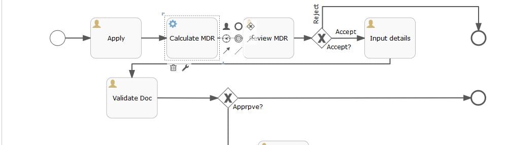

If it is necessary to explicitly indicate calculation process on the process diagram, you can use service task(Expression).
Setting service task as following.
・Task Type
Expression
・Expression
${execution.setVariable("C", execution.getVariable("A") + execution.getVariable("B") )}
