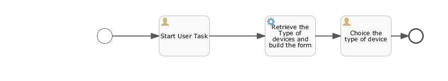

In my Activiti BPM process i have a Service Task to retrieve the information that i would use to build the Enum Form property in the next User Task activity as depicted in the image below.
Then in the Java class bound to the "Retrieve the Type of Device..." Service Task i need to retrieve the types of device and build the enum property to present to the user through Activiti Explorer.
I try to use the org.activiti.engine.FormService and org.activiti.engine.form.TaskFormData classes as listed in the code below but when i complete the "Start User Task" i receive the following error:
I think the error is throwed because the User Task with id "showSignalTask" doesn't exist yet. I have the doubt about the possibility to build programmatically a standard activiti form in this way:
