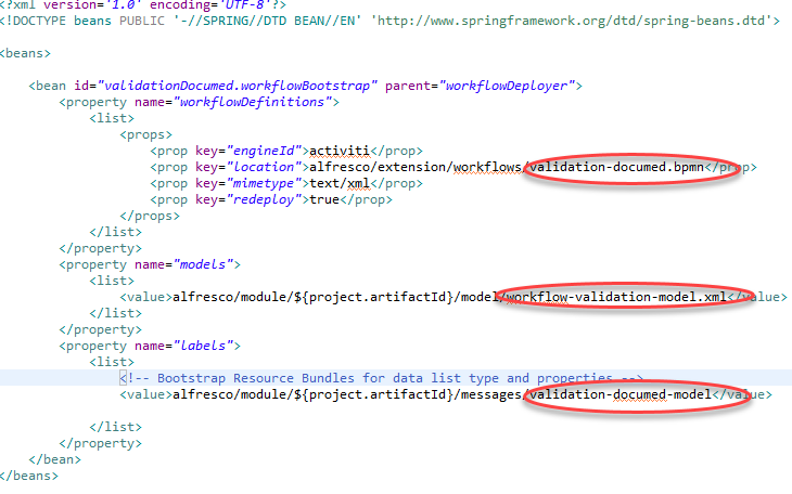

In my platform-jar, i have a worklow-validation-context (xxx-platform-jar/src/main/resources/alfresco/module/xxx-platform-jar/workflows) :
Can i use adf API to retrieve result (json ?) and put the items value in ADF form ?

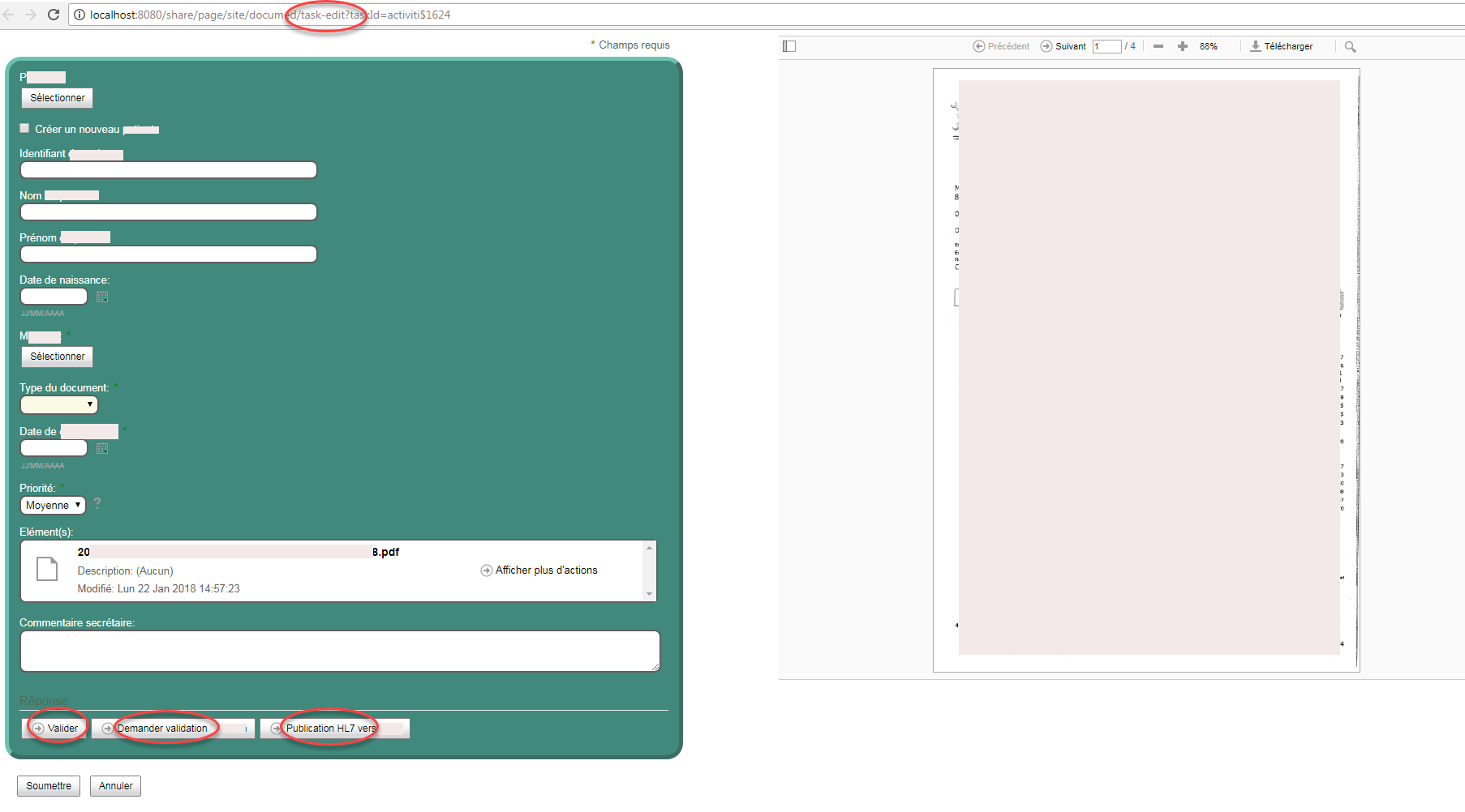

ADF is updated every day and I follow with great interest the GitHub - Alfresco/alfresco-content-app project, because it resumes a lot of functionnalities i need for my users :
I think i can use Share UI with admin profile to install the "environnement" : site, users, access, etc.... But i think it's possible , now, to use adf for user interface (profile <> admin). The only thing that's missing is to reproduce this form (first picture). But if i understand alfresco logic (complex for me), it's generated with alfresco FormProcessor and some config files (see my workflow-validation-context.xml). The aim of my project is very simple : Index documents pdf with a model document already defined (form fields) and generate HL7 files (java code in platform-jar). The project is ok with sdk2. We asked me to upgrade with sdk3 but i'm pretty sure that i can use adf for user interface. It would be modern and user friendly. Moreover i test my webscripts, defined in platform-jar, from an adf sandbox project and it works nice (ADF Component Catalog )! So adf can communicate with platform-jar.
My question is : Can FormServices (ADF Component Catalog ) be used to retrieve the fields defined in my config in order to create a beautiful form in a beautifull adf app ? Thx a lot

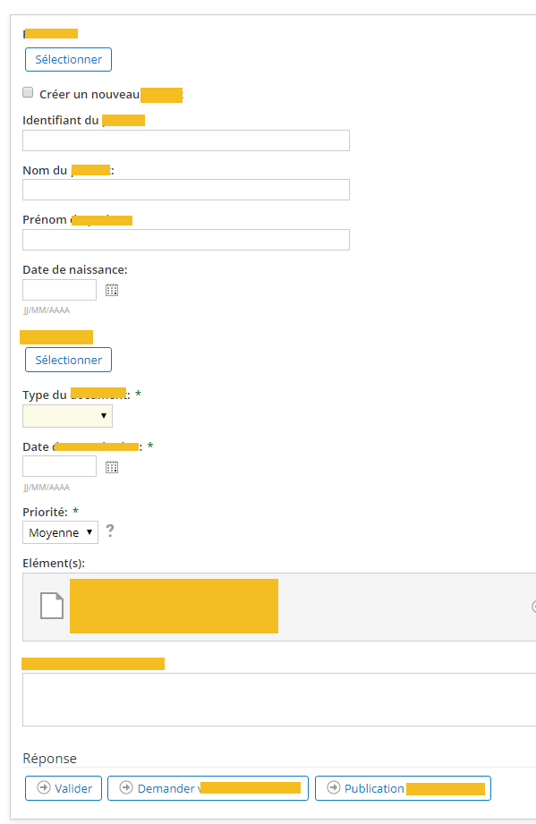

This is the complete screen i hope creating with ADF :
to resume : indexation = 1 form with 1 pdf and 3 actions buttons

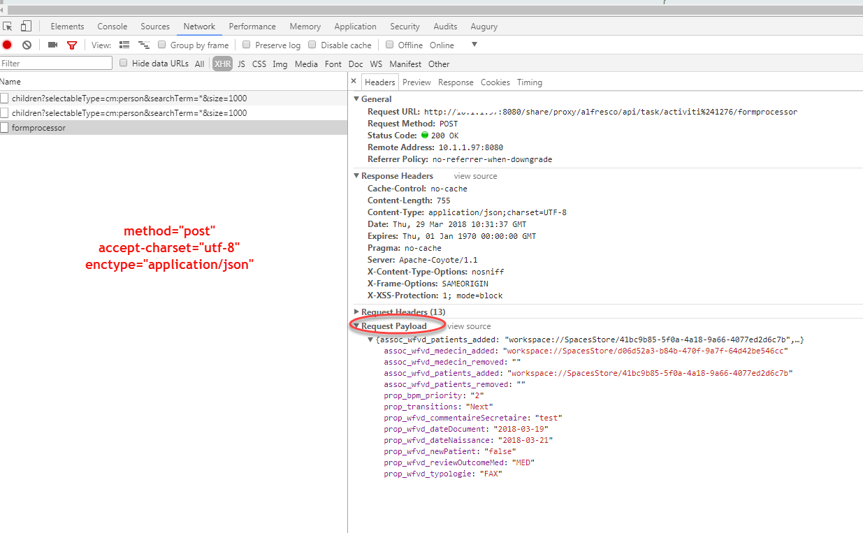

The last problem is to constitute POST method in order to submit my form :
This is the request when i submit form by using Share (formprocessor)
I suppose i must keep "formprocessor" request in order to update data (Tell me if i can do that by another way)
But i don't succeed to constitute correctly the request because of arguments type : Request Payload
How can i apply this kind of request ?
Thx
04-04-2018 04:34 PM
this is what i try :
but postForm must be String type so how can i compose properly this request , please ?
I also update directly alfresco-js-api.js by adding 'utf-8' in executeWebScript function
var accepts = ['application/json', 'text/html','utf-8'];
Thank you !!!
