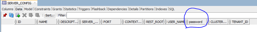

I found both USER_INFO and SERVRE_CONFIG tables have a column "password". After I changed the column name to "PASSWORD", the 'ORA-00904: "SERVERCONF0_"."PASSWORD": invalid identifier' error was gone. I am curious to know why the column name "password" has all lower-case character, while other column names have all upper-case characters. Is this a liquibase problem with oracle dialect?
I presume that the problem is that 'password' is a reserved word in oracle. I am not sure why changing the case resolved it but I think it has something to do with How do I escape a reserved word in Oracle? - Stack Overflow . Some tables use a prefix before the column name for the password Activiti/db-changelog.xml at 6.x · Activiti/Activiti · GitHub  but that one doesn't Activiti/db-changelog.xml at 6.x · Activiti/Activiti · GitHub  .
