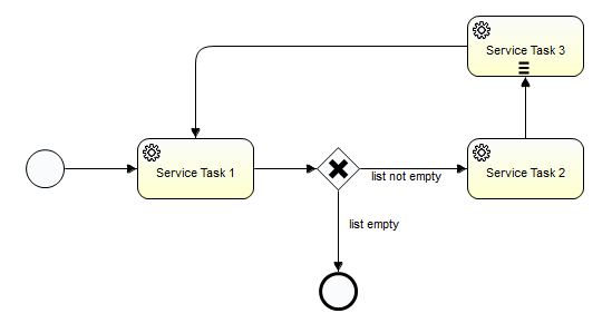

I have the below process. In my process there is a multi-instance service task that itself is a part of a loop.
The issue is that I'm getting the below exception after the process is finished.
If I'll make Service Task 3 not to be multi-instanced or if Service Task 3 will not be part of the bigger loop, then I'll not get the exception, so the exception is happening specifically for the case I mentioned.
org.activiti.engine.impl.pvm.PvmException: already taking a transition

The xml is:

How to solve it please?

So this is a known issue. if in some point in the process the list, that the multi-instance service task is using, becomes empty - then we'll get this exception.

Can you provide some code that can be use to reproduce the issue?

Service Task 2 and Service Task 3 are doing nothing.
Service Task 1 is below.
"index" is just a variable I'm passing when starting the flow.
public class ServiceTask1 implements JavaDelegate
@Override
public void execute(DelegateExecution execution) throws Exception
int index = execution.getVariable("index" , Integer.class);
List<String> myList = new ArrayList<String>();
if(index > 0)
for(int i = 0 ; i<index ; i++)
myList.add("test " + i);
index--;
execution.setVariable("index", index);
execution.setVariable("myList", myList);
