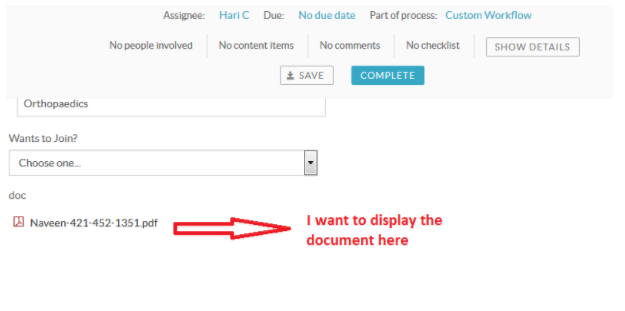

I am developing an application in Alfresco Activiti App which has multiple levels with different user actions. At 1st step I am generating a document using a form info and a template. Now, I would like to display the same document to the user in the next level.
I tried with Adding Attach  but I could not display document.
When I tried with Attach only document name is getting displayed like below:

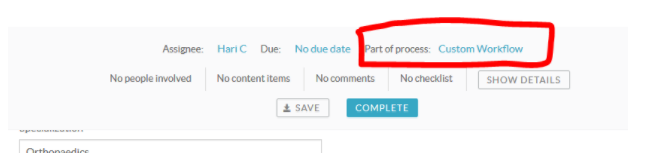

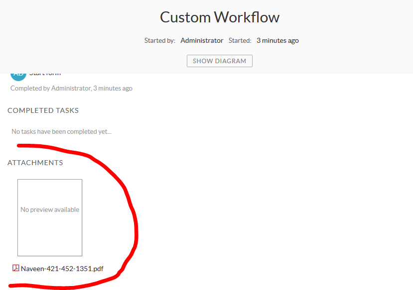

To view this document, I have to go to part of process and then view it like below:
Instead, How can I display the same document in the Tasks page itself?
