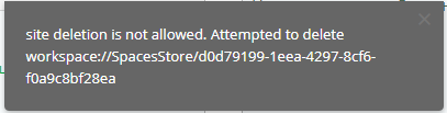

I am using alfresco 5.2. And I upgrade it from 4.0.
But now I can't remove site in alfresco. I have such error:
I authorized as admin and I am manager on this site. Also I authorized as other managers and try to delete this site, but
I saw the same error.
Maybe I can remove it mannually from AdminConsole or somehow else.
Best regards.

Mylogs:
127.0.0.1 - - [19/Oct/2017:09:55:15 +0300] "DELETE /alfresco/s/api/sites/testsite99?alf_ticket=TICKET_fa5eb614e9c375b494fc5efd7f58024aed0479a3 HTTP/1.1" 500 529
myComputerIp - - [19/Oct/2017:09:55:15 +0300] "DELETE /share/proxy/alfresco/api/sites/testsite99 HTTP/1.0" 500 529

And I found, that in admin-nodebrowser our site has two childs:
cm:testsite0 workspace://SpacesStore/d0d79199-1eea-4297-8cf6-f0a9c8bf28ea
cm:Copy of testsite0 workspace://SpacesStore/b2a28c8c-5823-4e3d-989e-dc45ff4e6080
So I can't delete thise two elements.
How to resolve this sittuation?
