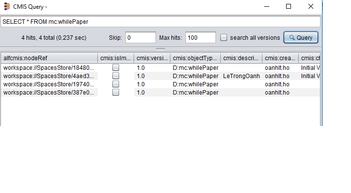

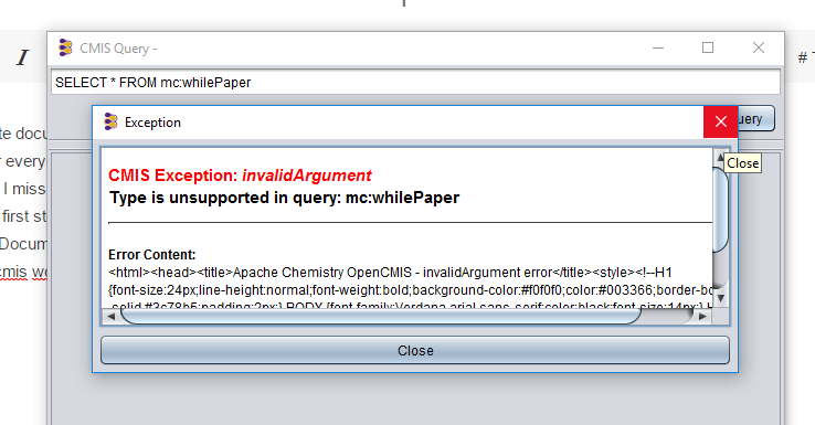

-in the first time I query document, the result return error
- I try query document again the result is ok

06-09-2017 04:12 PM
How are you creating your type? Are you defining it in XML and then restarting Alfresco? Or are you using the model manager in the Share UI?
Have you tried restarting CMIS Workbench after creating the type? Maybe the type list is getting cached.
06-09-2017 11:06 PM
Dear Jeff Potts, thanks for reply,
I created custom type on model mangager (based on link Alfresco 5.0 - Creating Models - YouTube ). Do you mean that I must restart Alfresco everytime I update model?
06-10-2017 08:05 PM
anyone can help?
06-12-2017 07:16 AM
Dear all member,
when I restart Alfresco, all Issue is fix.
So many thanks your help!
06-12-2017 07:41 AM
great - please select Jeffs answer as correct then! ![]()
