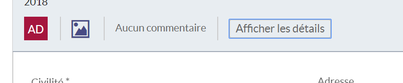

adding an attachment or a comment to a process seems to work as it's possible to switch to form and back to the comment/attachment tab and see both elements + I can see the fil uploaded on the server.
However, none is visible on next steps, is that a bug or do I need to do something special ?
Also, I've read some about the attachment field, makes no sense that its value can't be displayed in next steps, how should I proceed to make a custom element that will allow to display an url to download the attachment in question ?
