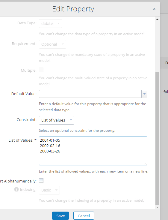

in our company we use Alfresco where we added new TestModel and ListDate property.

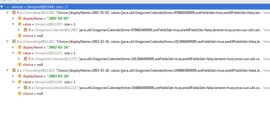

Next we use CMIS Apache Chemistry connector that returns list of choices:
When one of these values is chosen for update, error appears. For instance, if we choose the first one (2001-01-05 == 5 of January 2001)

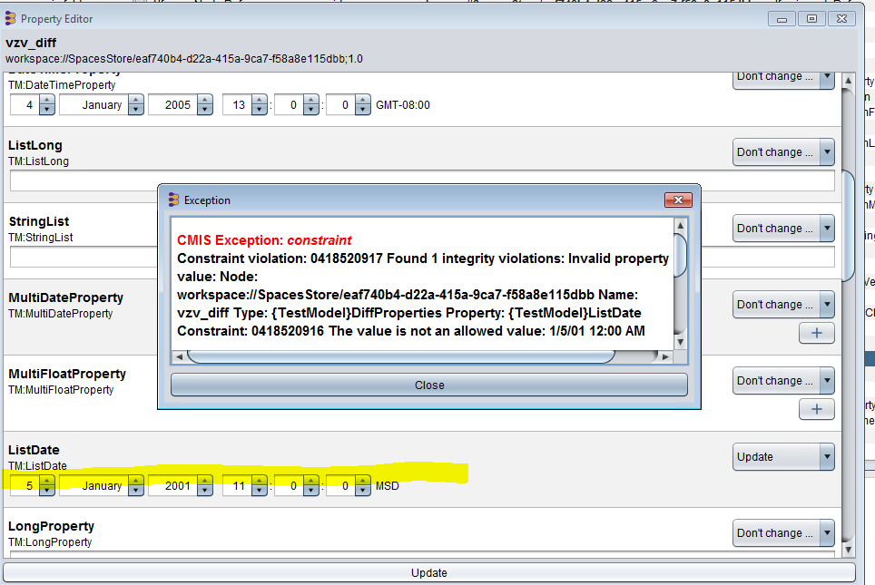

ZONE_OFFSET=-28800000,DST_OFFSET=0]It worth noting that on "Client machine" time adjusted with utc +3,
whereas on "Server (where Alfresco is actually installed)" - utc -8.
Our assumption is that Alfresco expected 0:00 am or 0:00 pm and that 12 am is summarized from UTCs scales.
Despite the fact that this situation is already weird, adjusting time of that value in any way before update didn't help at all.
Let's say, setting hours
calendar.add(Calendar.HOUR_OF_DAY, 12);results in

Constraint: 0418520817 The value is not an allowed value: 1/5/01 12:00 PMApache Workbench behaves the same way (but it has no choices though):
None of variants are suited here.
