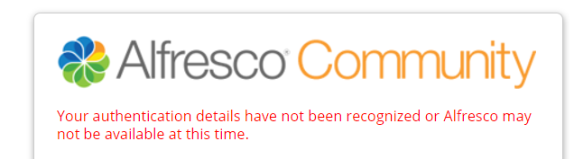

We cannot login to our on-premise repository of Alfresco Community. All our users have tried with their login credentials and no one can login. We get this error message on the login screen:

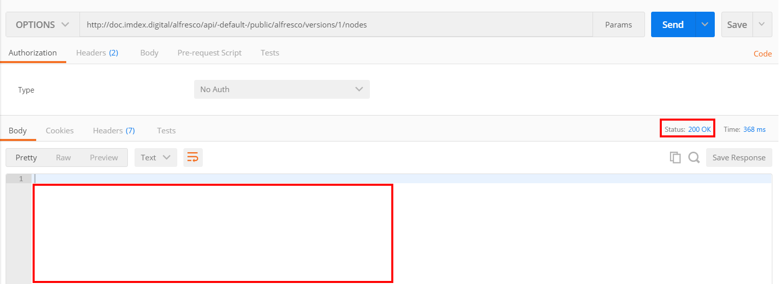

When I do an on-premise call using Postman OPTIONS using this request below but for our instance, the Status returns as '200 OK' (see screen shot below) but the Response is not returned (see blank red box in screenshot below).
http://localhost:8080/alfresco/api/-default-/public/alfresco/versions/1/nodes
Is anyone able to recommend a solution?

05-03-2017 10:36 PM
Thanks Douglas for your reply and advice.
We have identified that the problem is disk full due to the Apache access logs growing to 11GB.
