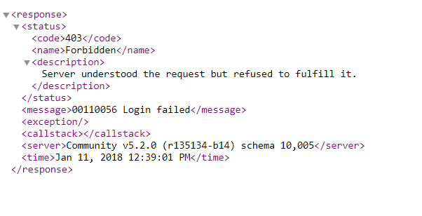

As a result system is connected to the database but when I try to login nothing happens except page reloading.
Running the authentication webscript it returns following:
I have tried following:
1. Created a new empty database afterwards login works
2. Added following line of code in alfresco-global-postgresql.properties
alfresco.cluster.enabled = false
3. Tried to change the password directly in the database referencing to: Admin password in default authentication | Alfresco Documentation. One interesting thing here is that sql query intended for the latest Alfresco did not work, I had to use the one that was intended for the lower versions - doesn't help.

I have solved this. The problem was related to the alfresco-global.properties. In the previous Alfresco version there were required system related properties that I missed to set in the new version.
